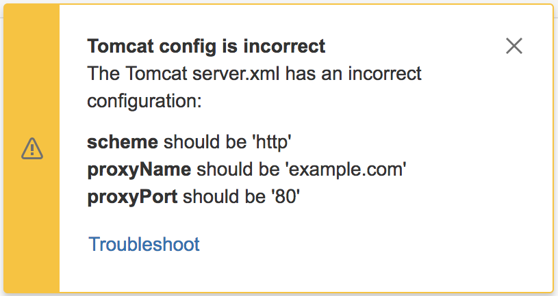

Confluence displays the following message to administrators:
Tomcat config is incorrect
The Tomcat server.xml has an incorrect configuration:
scheme should be '<recommended scheme>'
proxyName should be '<recommended proxyName>'
proxyPort should be '<recommended proxyPort>'
