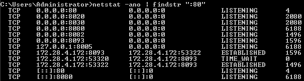

First, identify which Process is binding the desired port by running this from the Command Prompt: (all examples will assume port 80 for simplicity)
1
netstat -nao | findstr ":80"
You should get an output similar to this:
Next, use the ProcessID (value in the last column) to find out which process is holding the port:
1
tasklist | findstr "4"
Output:
In this case, the System process is binding port 80. As mentioned above, this is typically either the IIS service, or the HTTP.sys driver binding the port for WRM or Print Spooler.

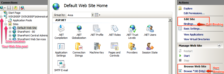

Check to see if IIS is binding the port from the IIS manager by expanding the Web Site name, then the Sites location and select a site. The Browse Web Site section in the right nav menu should include the port binding:
IIS is currently binding port 80 for the Sharepoint site running on this server. To change the bind port for the site, click Bindings... under Edit Site. This change will require a restart of the site.
