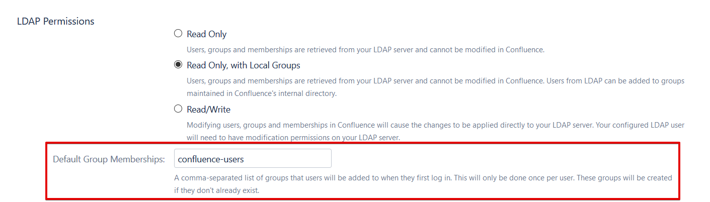

When connecting Confluence to an external user directory, Confluence has a setting to automatically add users into Default Groups when users first login:
However, when users login, they are not automatically assigned to this group. This usually accompanied by getting "Not Permitted" error as usually the group assigned is the group that has the "Can-Use" permission.

  • User directory is a Connector with Read Only, with Local Groups permission
    • Default Group Memberships setting has been configured, and the field is not empty
  • User Directory is a Delegated directory (Internal with LDAP Authentication)
    • Copy User on Login has been ticked
