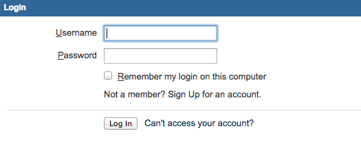

The user will see this screen in Confluence after they have accessed JIRA. This will appear when they try to access anything inside Confluence.

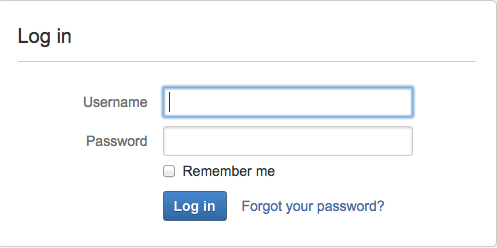

The user will see this screen in JIRA after they have accessed Confluence. This will appear when they try to access anything inside JIRA
