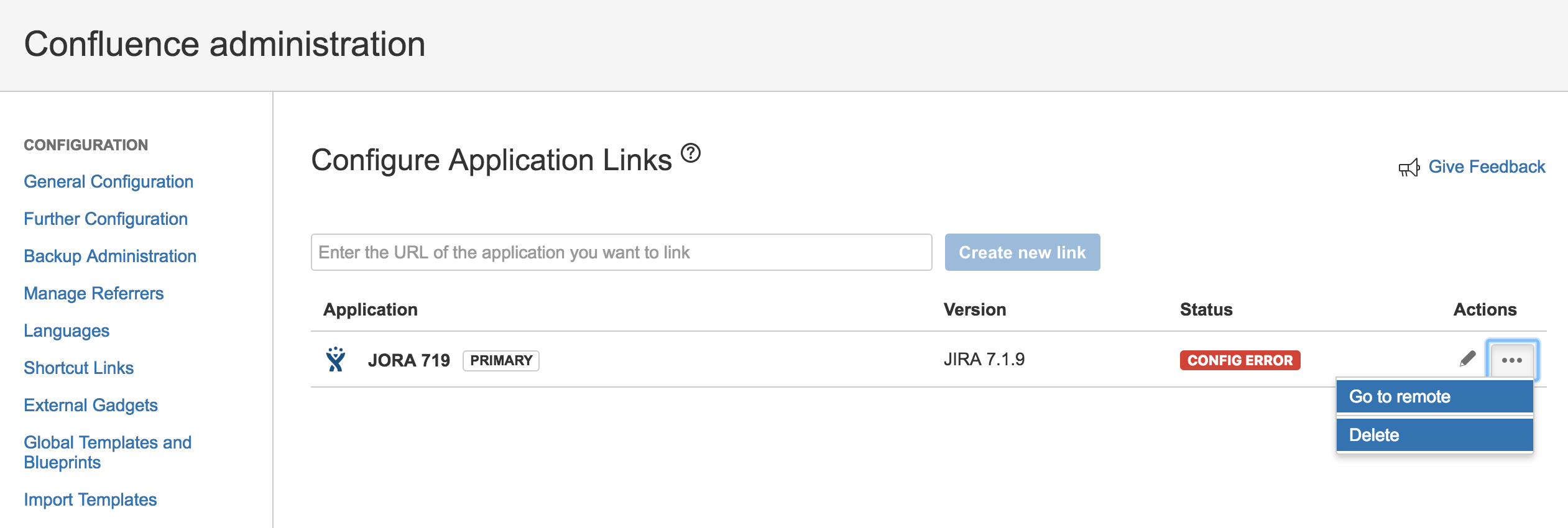

Before performing the steps from the Resolutions section, please first ensure that you've tried to delete the Application Link configuration from the Configure Application Links page (Confluence Administration page >> Application Links) as shown in the screenshot below.
If you are still unable to delete the configured Application Link, please then proceed to the Resolutions section of this KB.
