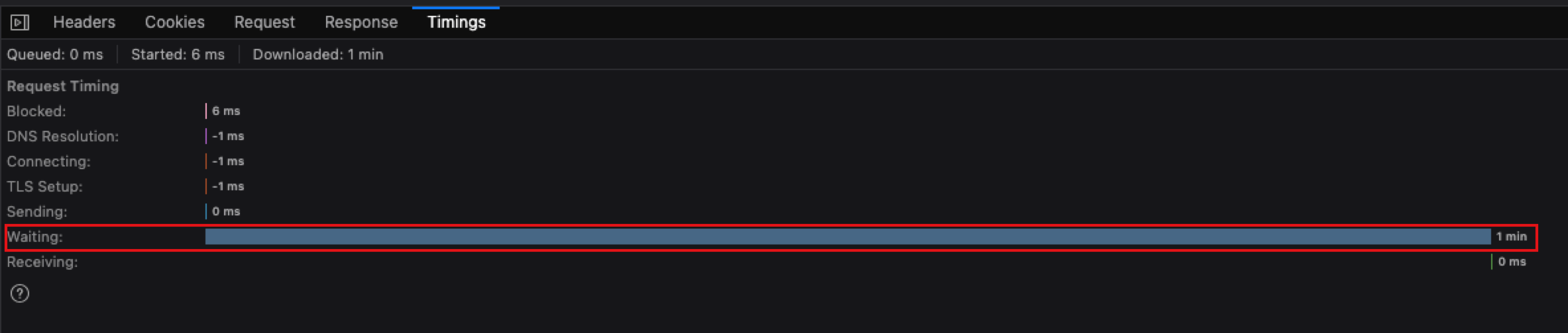

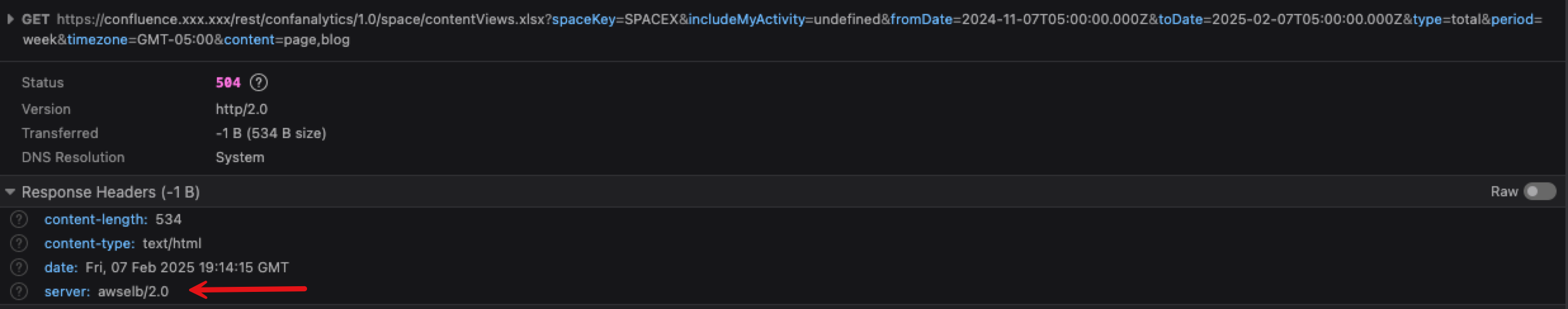

  • A minute later it errors out with code 504 Gateway Timeout. You should see something like the images below in your browser dev tools:
ℹ️ Notice that the status 504 was returned by the load balancer AWS ELB and the timings shows that the browser waited for 1 minute. The 1 minute here is the load balancer/proxy connection timeout.
