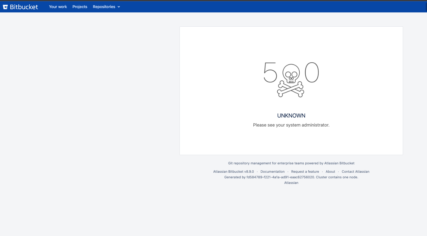

While browsing to the specific repository in Bitbucket shows error 500 below:
