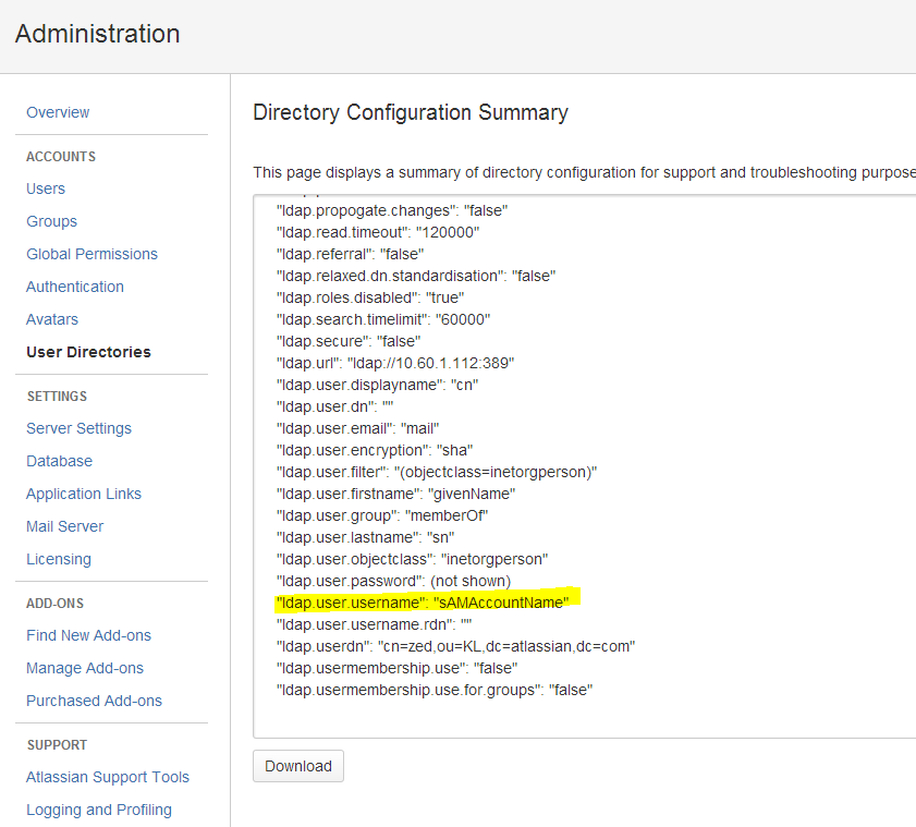

Compare the user's LDIF with the Directory Configuration Summaryand look for the attribute "ldap.user.username".The error occurs when there is a mismatch between the users LDIF settings and the directory settings.

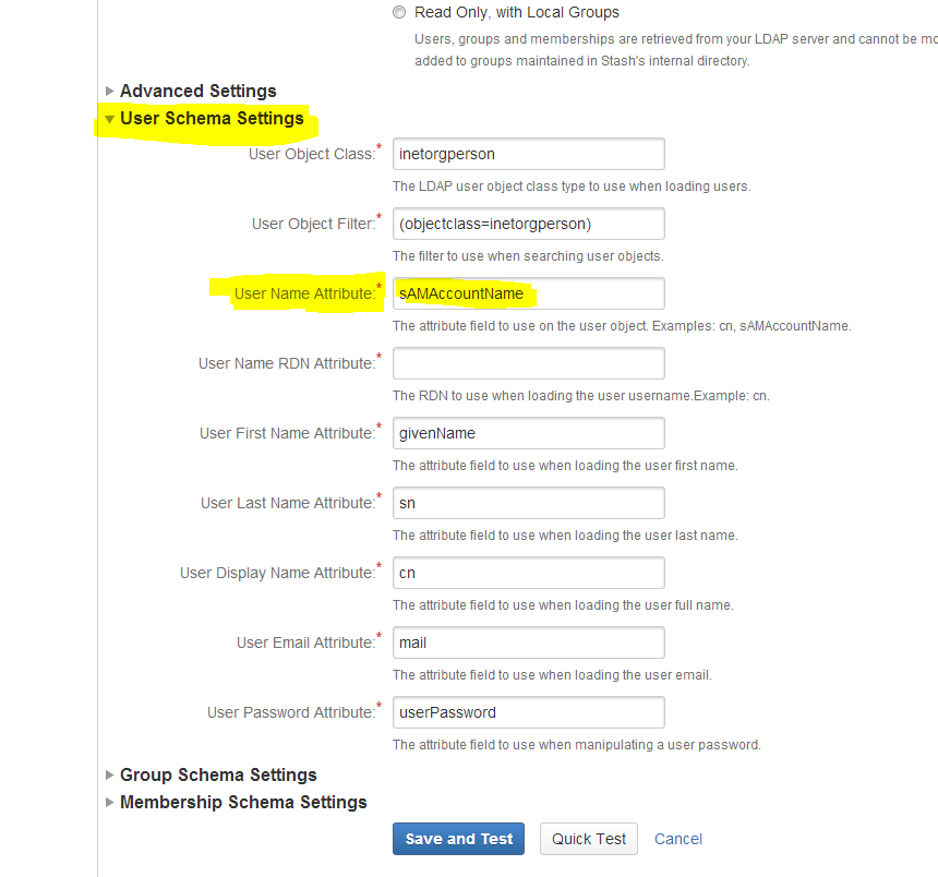

If the user name attribute set in LDAP Directory setting is different from the user name attribute in LDAP schema, Bitbucket Server won't be able to find the username for the user in LDAP. This results in "unable to find the username of the principal" error.
Resolution 1
Update the User name attribute to match the LDAP schema

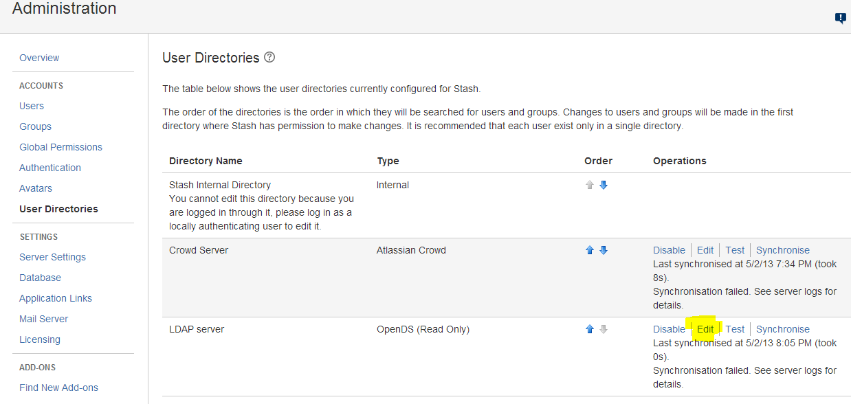

  1. Go to User Directories and Edit the directory >> User Schema Settings >> User name Attribute
  2. Update the attribute to match the username attribute in User's LDIF schema (Eg: cn, uid, sAMAccountName)
