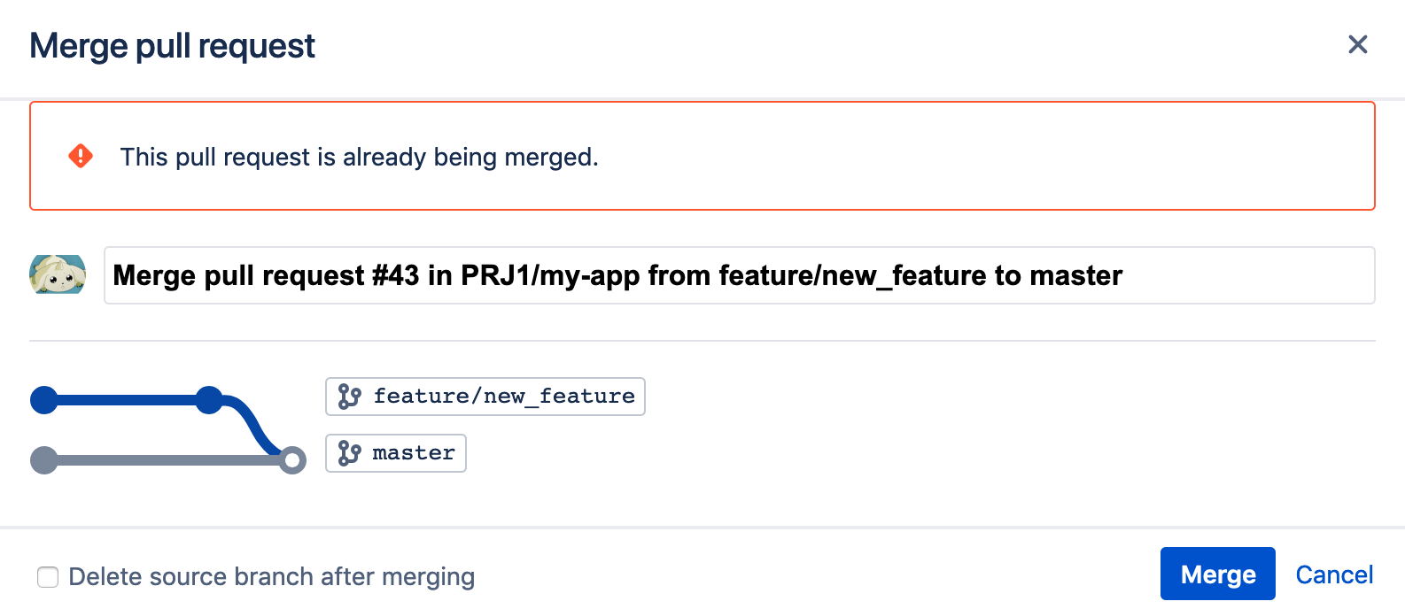

Merging a pull request cannot be completed and the message "This pull request is already being merged" is displayed.
As the message indicates, the pull request cannot be merged because the merge is already in progress.
This can occur in the following scenarios:
Case 1: More than one user tried to merge the pull request
There may be more than one user who tried to merge the same pull request at around the same time.
When the first user initiates the merge, the second user will not be able to merge the pull request and will receive the message.
Case 2: A user tried to merge the pull request several times
A user tried to merge a pull request more than once because the first try appears to take a long time.
The succeeding merge attempts will show the message while the first one is still in progress.
