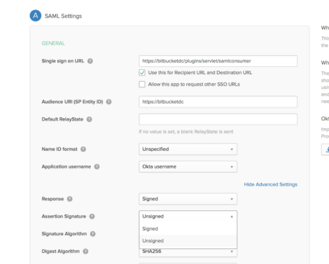

  1. The IDP signs the Response only, but not the Assertion. Currently Bitbucket requires the Assertion to be signed, so once the issuer check passes, the authentication fails with an error: "The Assertion of the Response is not signed and the SP requires it".
  2. Trailing whitespace characters for com.atlassian.plugins.authentication.samlconfig.sso-issuer and com.atlassian.plugins.authentication.samlconfig.sso-url.
Resolution
  1. Configure the SAML identity provider to provide a signed Assertion.There should be a drop down option similar to the below:
  2. Remove any white spaces in Bitbucket's SAML configuration.
