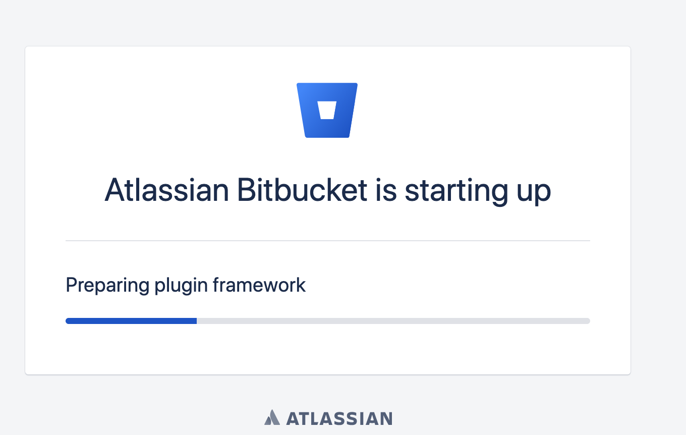

  • The startup is stuck on Preparing plugin framework
