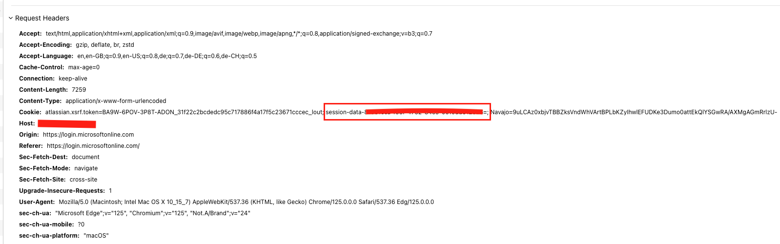

Capture a HAR while reproducing the issue
Generate HAR file following the guide Generating HAR files and analyzing web requests. From analyzing the HAR, you will see session-data-xxxx-xxx-xxxx-xxxx cookie value is empty.

  • The error exception "Received invalid SAML response: The Response has an InResponseTo attribute: ONELOGIN_######aBc##fgc while no InResponseTo was expected" is returned mostly when the Reverse proxy/WAF(Web Application Firewall) blocks some session data. The session-data-xxxx-xxx-xxxx-xxxx cookies were not being sent to the backend server by the reverse proxy/WAF.
Solution
If using reverse proxy/WAF, the solution is to inspect the traffic on the Reverse proxy & validate where the session cookie data is being filtered out. Ensure that session cookie data is forwarded from the reverse proxy to the backend servers.
