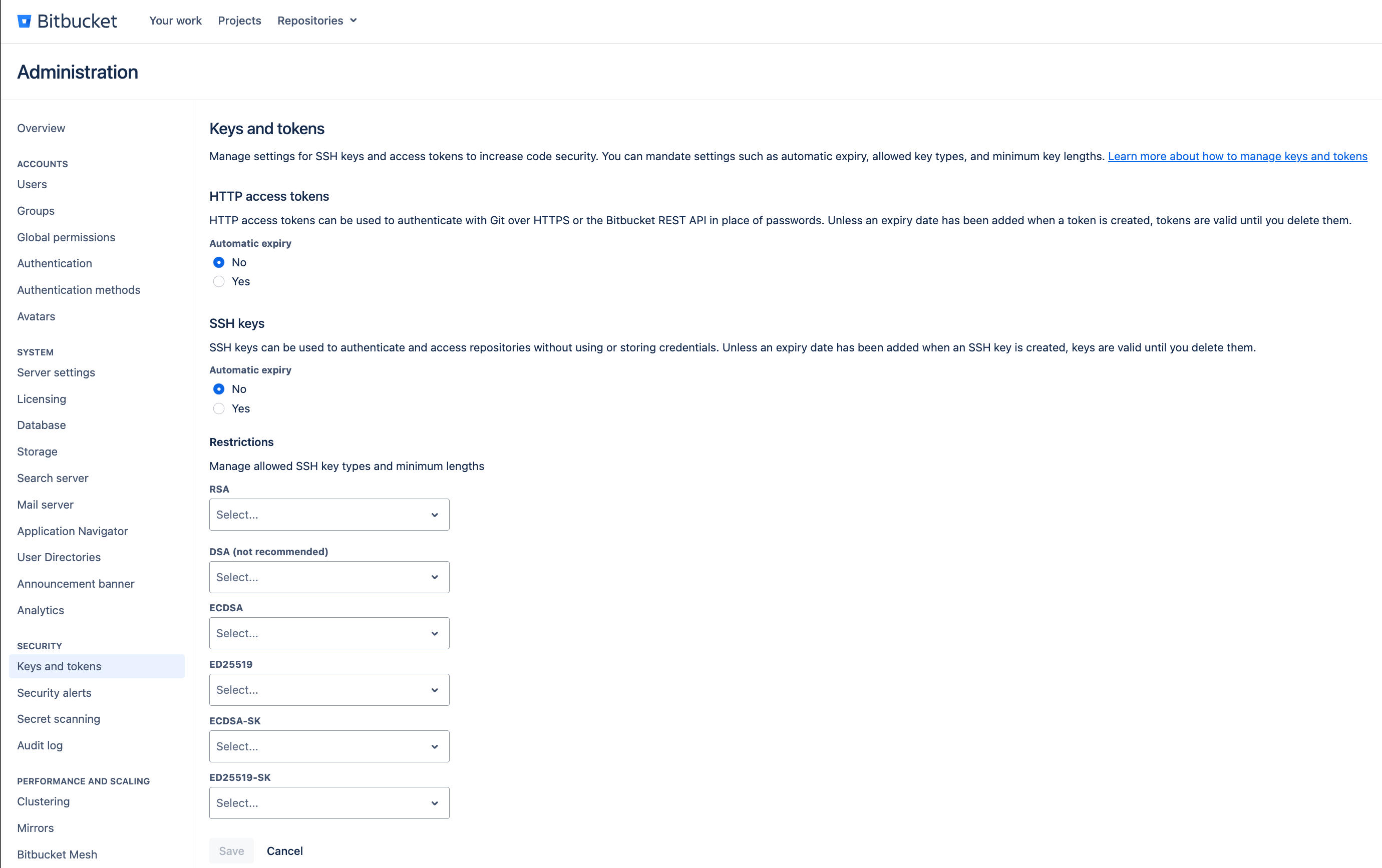

Additionally, the “Keys and Tokens” page may not display the expected key restriction values, preventing updates or additions of SSH keys at any level (Global/Project/Repository).

  • The “Restrictions” field under “Keys and Tokens” displays “Select…” instead of populated values.
    image of Bitbucket Data Center Keys and Tokens screen
