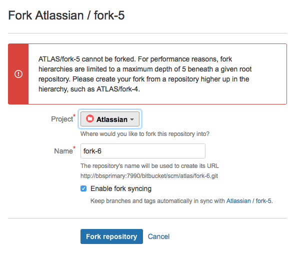

Trying to create a fork fails with the following error:
<repo> cannot be forked. For performance reasons, fork hierarchies are limited to a maximum depth of 5 beneath a given root repository. Please create your fork from a repository higher up in the hierarchy, such as <repo-parent>.

In the above scenario, if you attempt to fork fork-5.git you will be met with the following error:
