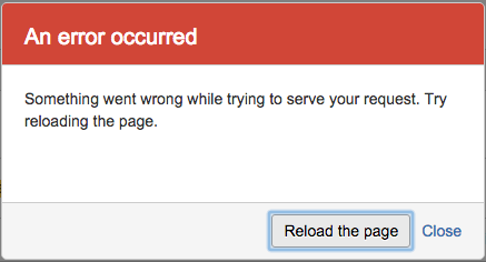

Symptoms
If your Bitbucket Server instance has been misconfigured to allow HTTP or mixed HTTP/HTTPS access, then you may observe the following error being triggered by Bitbucket's XSRF protection.
