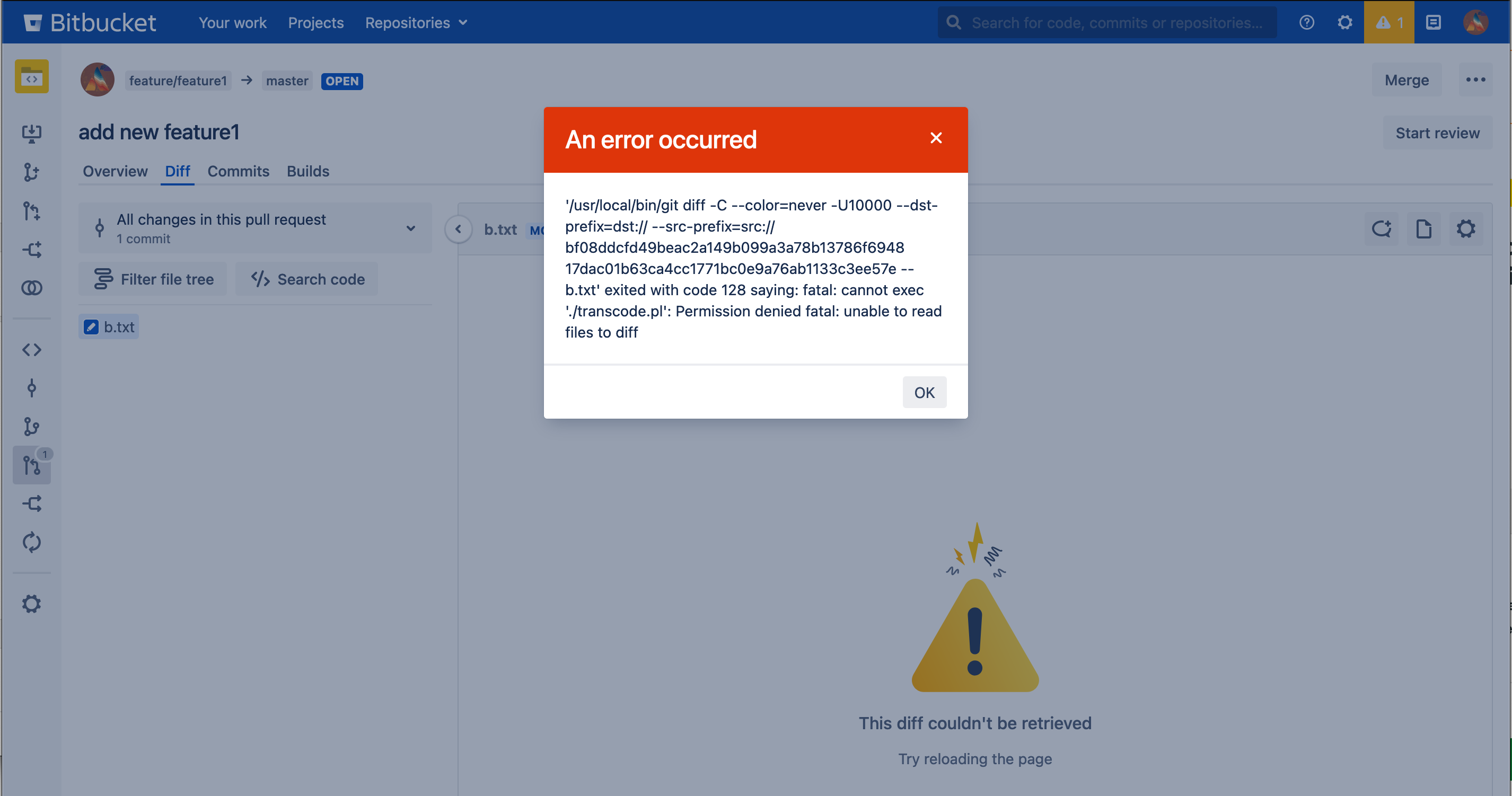

The pull request diff cannot be displayed for a repository where the Transcode diffs option has been enabled.
The following error is shown when attempting to display the diff:

If the Bitbucket OS user is unable to access and execute the transcode.pl script for any reason, the fatal: cannot exec './transcode.pl': Permission denied error will be encountered and the pull request diff cannot be displayed in the UI.
