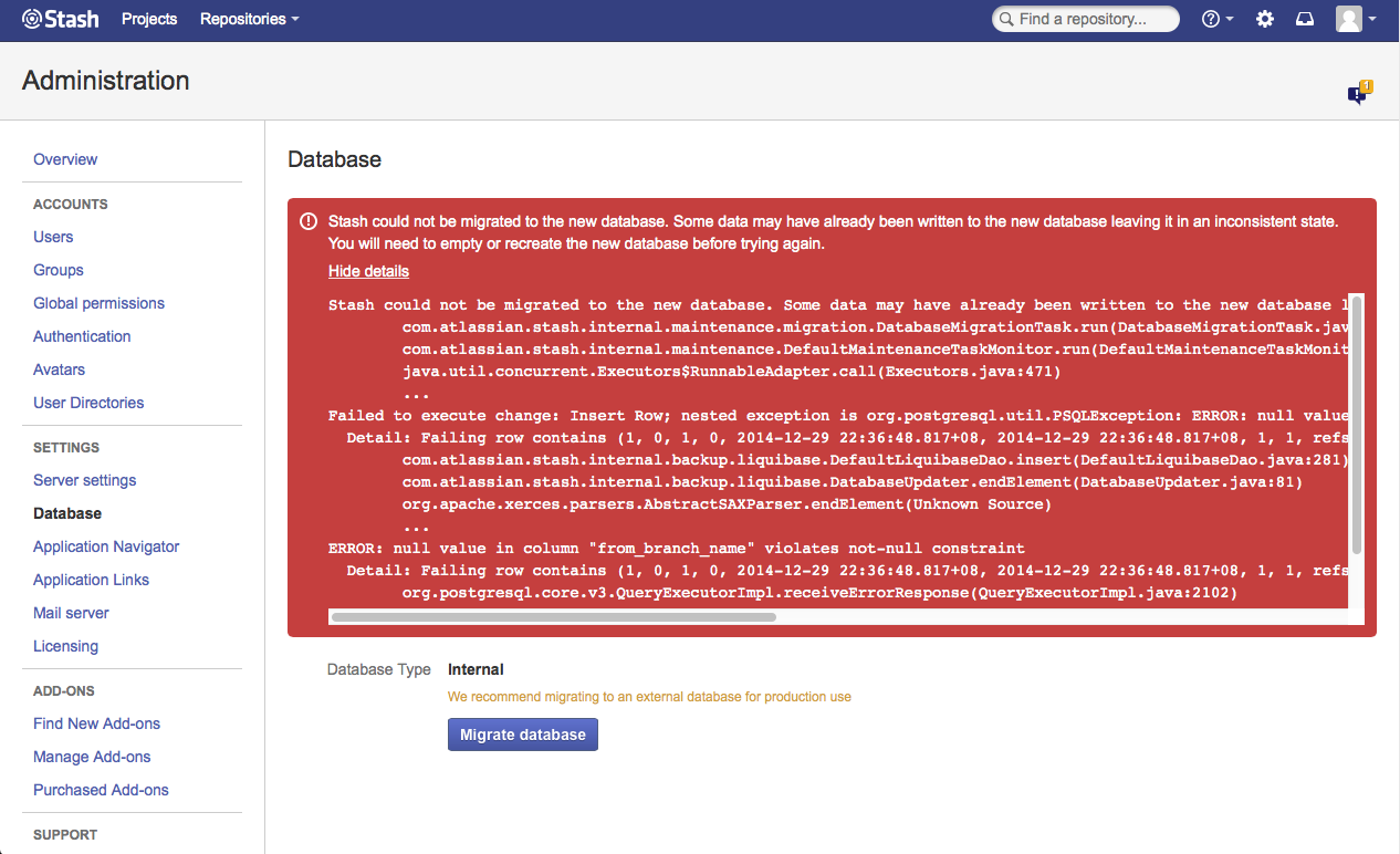

The following appears in Bitbucket Server 2.7.1 Migration Setup UI:

Bitbucket Server could not be migrated to the new database. Some data may have already been written to the new database leaving it in an inconsistent state. You will need to empty or recreate the new database before trying again.
com.atlassian.bitbucket.internal.maintenance.migration.DatabaseMigrationTask.run(DatabaseMigrationTask.java:44)
com.atlassian.bitbucket.internal.maintenance.DefaultMaintenanceTaskMonitor.run(DefaultMaintenanceTaskMonitor.java:172)
java.util.concurrent.Executors$RunnableAdapter.call(Executors.java:471)
Failed to execute change: Insert Row; nested exception is org.postgresql.util.PSQLException: ERROR: null value in column "from_branch_name" violates not-null constraint
Detail: Failing row contains (1, 0, 1, 0, 2014-12-29 22:36:48.817+08, 2014-12-29 22:36:48.817+08, 1, 1, refs/heads/null, refs/heads/master, null, master, 8e33651530fffc4fa06bd912396b7e118af02df3, d88a6550790e4aff0538508675565be6ec9e97e0, null, 2).
com.atlassian.bitbucket.internal.backup.liquibase.DefaultLiquibaseDao.insert(DefaultLiquibaseDao.java:281)
com.atlassian.bitbucket.internal.backup.liquibase.DatabaseUpdater.endElement(DatabaseUpdater.java:81)
org.apache.xerces.parsers.AbstractSAXParser.endElement(Unknown Source)
org.postgresql.core.v3.QueryExecutorImpl.receiveErrorResponse(QueryExecutorImpl.java:2102)
org.postgresql.core.v3.QueryExecutorImpl.processResults(QueryExecutorImpl.java:1835)
org.postgresql.core.v3.QueryExecutorImpl.execute(QueryExecutorImpl.java:257)
Diagnosis
Migrating to a clean mySQL database on Bitbucket Server 2.7.1 with the presence of the character "null" in sta_pull_request
table will result in a failure of the migration that will return the error on the screenshot above.
