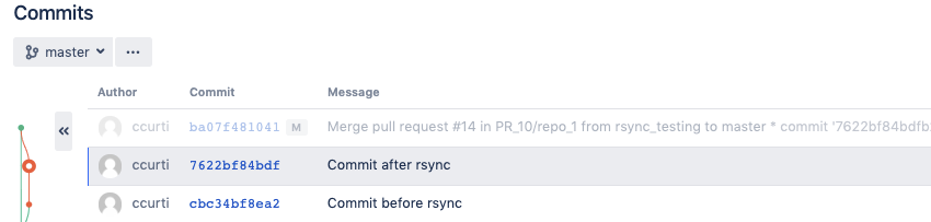

Second Rsync
The $REPOSITORY_HOME/packed-refs file will be synchronized while the $REPOSITORY_HOME/refs/heads/rsync_testing file will not because the file does not exist.
In the target environment, the refs/heads/rsync_testing is still present and contains the hash of the first commit:
cat refs/heads/rsync_testing cbc34bf8ea2548c37d853a934b8af0a58e436fe1
The packed-refs contain the updated value with the hash of the second commit.
cat packed-refs | grep "refs/heads/rsync_testing" 7622bf84bdfb2fae299609a38b09e7bfdea22b00 refs/heads/rsync_testing

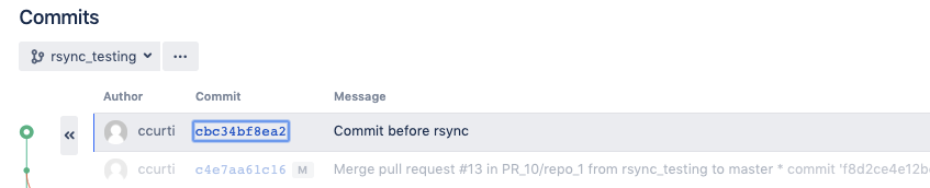

The git logic gives the precedence to the content of the loose refs (refs/heads/rsync_testing) so the history will show the

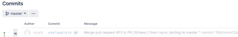

Source environment - master branch

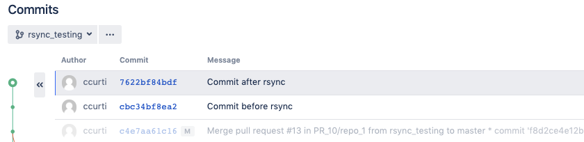

Source environment - rsync_testing branch
Target environment - rsync_testing branch

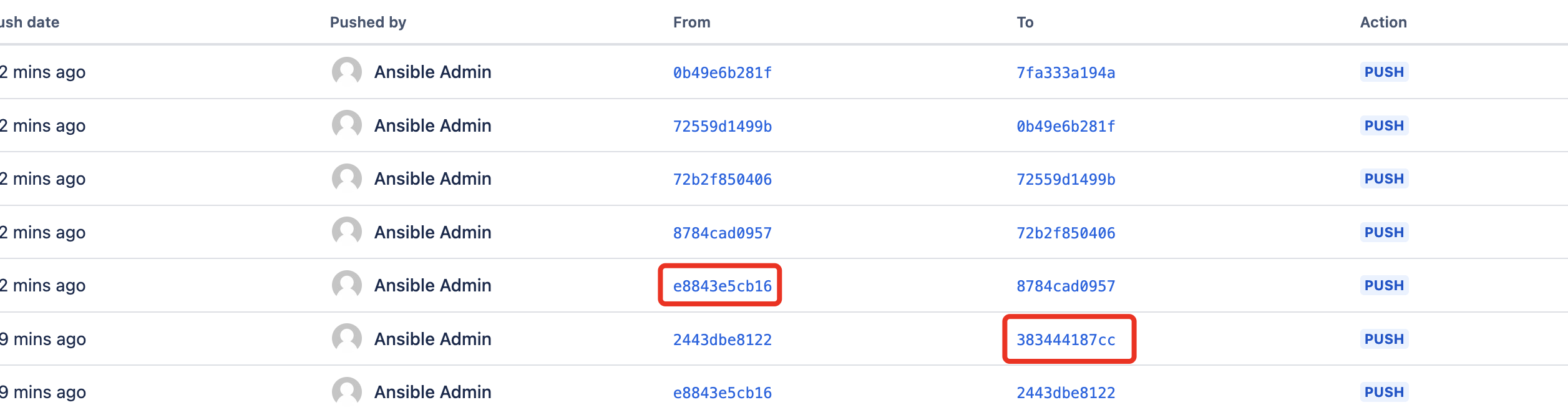

Example Script to detect inconsistencies using Push Logs
To identify repositories impacted by this event, you can analyze the entries in the push logs. These logs record the 'fromHash' and 'toHash' for each ref update event. Under normal circumstances, the 'fromHash' of a new entry should match the 'toHash' of the preceding entry.
If a branch has been unexpectedly reset to a different commit, possibly due to a filesystem migration, this in theory could be detected from its push logs.
Below is a sample script, that would look for this discrepancy in the first n entries of the Push logs for a particular branch recursively through repositories.

This script uses two Scenarios to detect inconsistencies in the Push logs.
Scenario 1
  • The script leverages the Push Log API to retrieve the latest 'n' ($PAGE_LIMIT) entries from $REF_NAME branch. It then recursively compares the ToHash of each previous entry with the FromHash of the current entry.
  • This is to cover the situations where new commits have been made to the branch, assuming that any divergence occurred within the latest 'n' ($PAGE_LIMIT) entries.
Scenario 2
  • Next the script utilizes the Push Log API and the Find Branch API to verify if the latest ToHash in the push logs matches the latest commit on the $BRANCH_NAME branch.
  • This is to cover the scenario situations where no new commits have been made to the branch or push log since the last reset.
You would need to update below env variables in the script (PAGE_LIMIT determines the number of push log entries to be checked)
BASE_URL="" PAGE_LIMIT=30 REF_NAME="" USERNAME="" PASSWORD=""
Additionally the script expects a file named project_repo.txt in the same directory where it is run which has a list of Project keys and repo slugs in the following format
NPROJ repo1 NPROJ repo2 NPROJ repo3
If everything goes well, you should see output of the script as follows:
% ./push-log-check.sh =================================================== Processing project: NPROJ, repository: repo1 =================================================== Latest hash: f55e42c501aff8364723f9349020399614737726 Hash comparison completed. Latest hash as per push logs f55e42c501aff8364723f9349020399614737726 The latest commit in the branch matches the latest toHash from activities for NPROJ/repo1. =================================================== Processing project: NPROJ, repository: repo2 =================================================== Latest hash: 19bc028c43bdb57d14e72d7f3e4ace1974988ef1 Hash comparison completed. Latest hash as per push logs 19bc028c43bdb57d14e72d7f3e4ace1974988ef1 Mismatch: The latest commit in the branch (c879d339de8f966f52524d1c90b50a714d91532e) does not match the latest toHash (19bc028c43bdb57d14e72d7f3e4ace1974988ef1) in Push logs for NPROJ/repo2. =================================================== Processing project: NPROJ, repository: repo3 =================================================== Mismatch found: previous toHash '383444187cc85a5e947b0abcc85e93672d680b55' does not match current fromHash 'e8843e5cb1604e7c5f4b5d45d6f8ce6af4984898' in the push log entry number 4 Latest hash: 7fa333a194a0a9cabfb7028ea4b0f892620a8e01 Hash comparison completed. Latest hash as per push logs 7fa333a194a0a9cabfb7028ea4b0f892620a8e01 The latest commit in the branch matches the latest toHash from activities for NPROJ/repo3.
In the above example the inconsistencies are found in repo2 and repo3.
Please note that creating custom scripts falls outside the scope of our standard support offerings. The provided script is intended solely as a reference and is crafted on a best-effort basis. It has not been rigorously tested to account for every potential edge case, so it is crucial that you conduct your own diligence to customize and thoroughly test the script to fit your specific needs. This script is not covered under Atlassian Support, and therefore, we are unable to assist with troubleshooting or further customization. We recommend that you or your team take responsibility for ensuring it meets your requirements.
