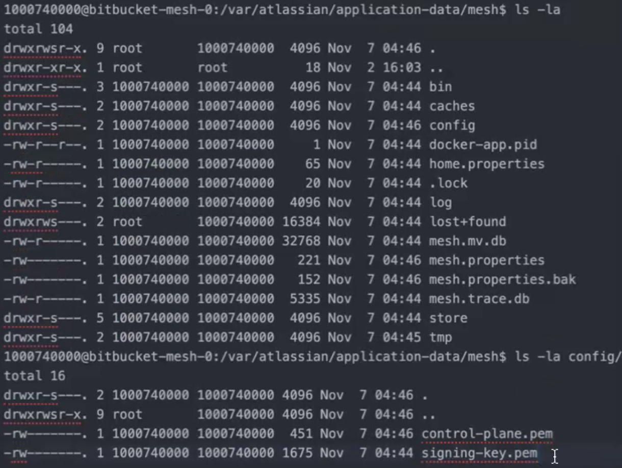

kubectl exec -it pod/bitbucket-mesh-0 bash -n bitbucket

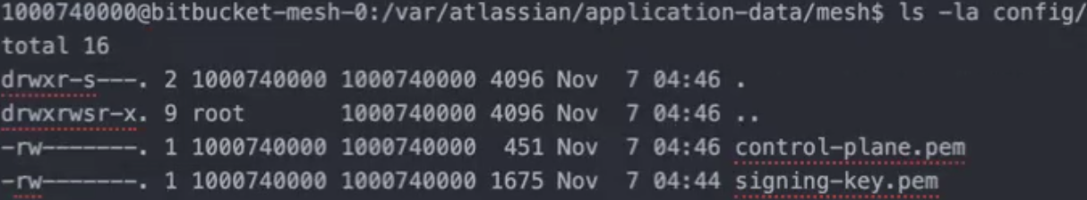

  • Check the Permissions of the files in the /var/atlassian/application-data/mesh/config directory:
ℹ️ Here /var/atlassian/application-data/mesh is the Mesh home directory. It could be different in your setup.

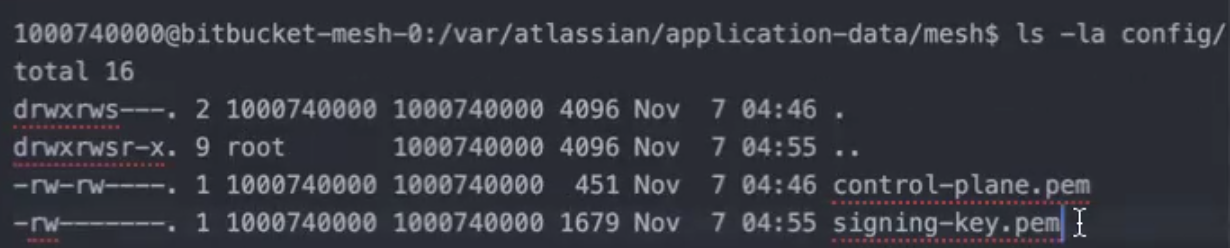

  • If for some reason the Mesh pods are restarted, the permissions on the control-plane.pem file change as the following:
  • The permissions change from 600 to 660. In other words, from -rw------- to -rw-rw----

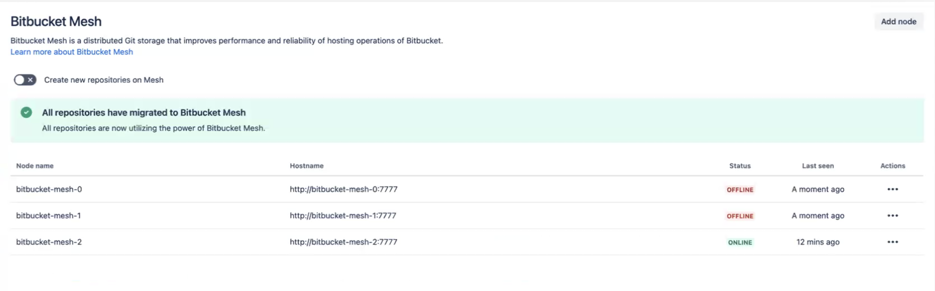

  • This causes the Mesh pods to not come up after the restart and hence the Bitbucket Mesh UI shows all the Mesh nodes as OFFLINE.
