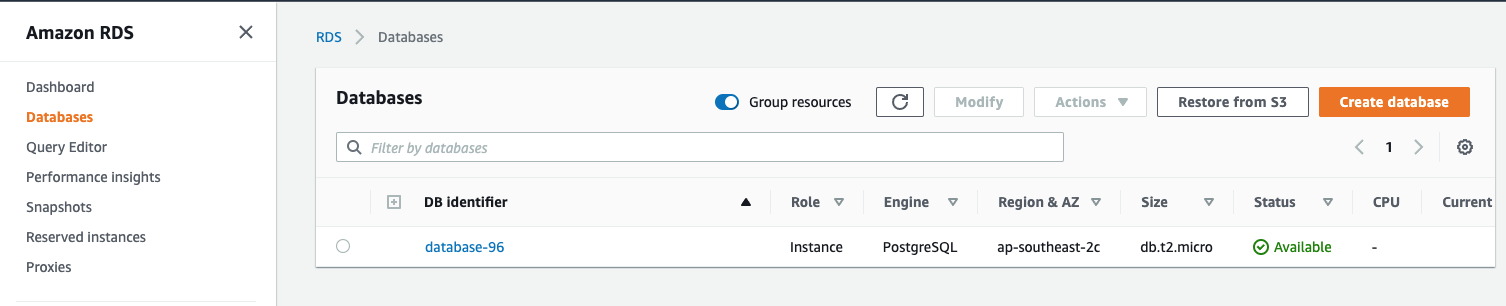

  1. Sign in to the AWS Management Console, use the region selector in the navigation bar to choose the AWS Region for your deployment, and open the AWS RDS console at https://console.aws.amazon.com/rds.
  2. In the navigation pane, click Databases. From there, select your database instance. You can use the search bar to filter instances by name.
    Amazon RDS console - Databases option

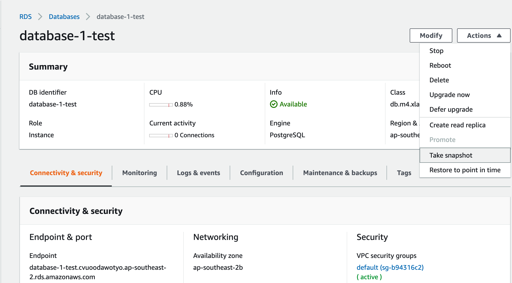

  3. From the Actions drop-down, select Take snapshot.
    Amazon RDS database - option Take snapshot

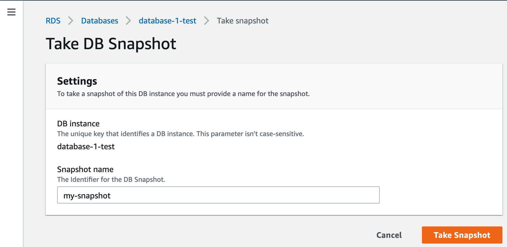

  4. The Take DB Snapshot page appears. Enter a name for your snapshot and click Take Snapshot.
    Amazon RDS database - Page Take Snapshot
For more information, see Creating a DB Snapshot.

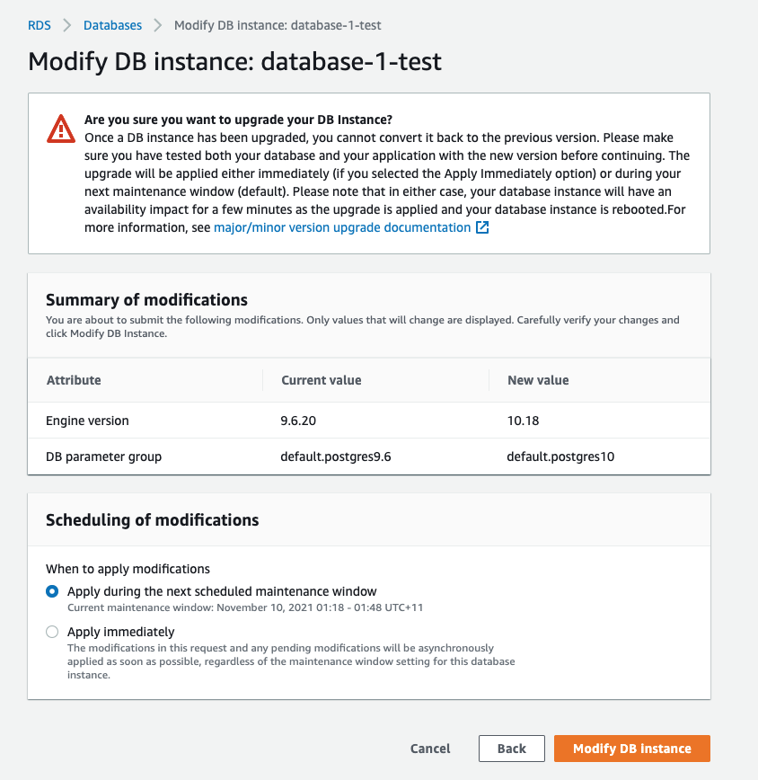

  3. Click Modify. The Modify DB Instance page appears. From there, select 10.18 from the DB engine version drop-down selection.
    Modify DB instance page in Amazon RDS, where as DB engine version we select 10.18
  4. Choose Continue and check the summary of modifications. By default, the database engine version upgrade will be queued and applied on the next scheduled maintenance window.
    Screen to confirm modifications to the DB instance
    If you prefer to apply the changes immediately, choose Apply immediately. This option can cause an outage in some cases. For more information, see Using the Apply Immediately Setting.
  5. Click Modify DB Instance to save your changes.
For more information, see Manually Upgrading the Engine Version.
