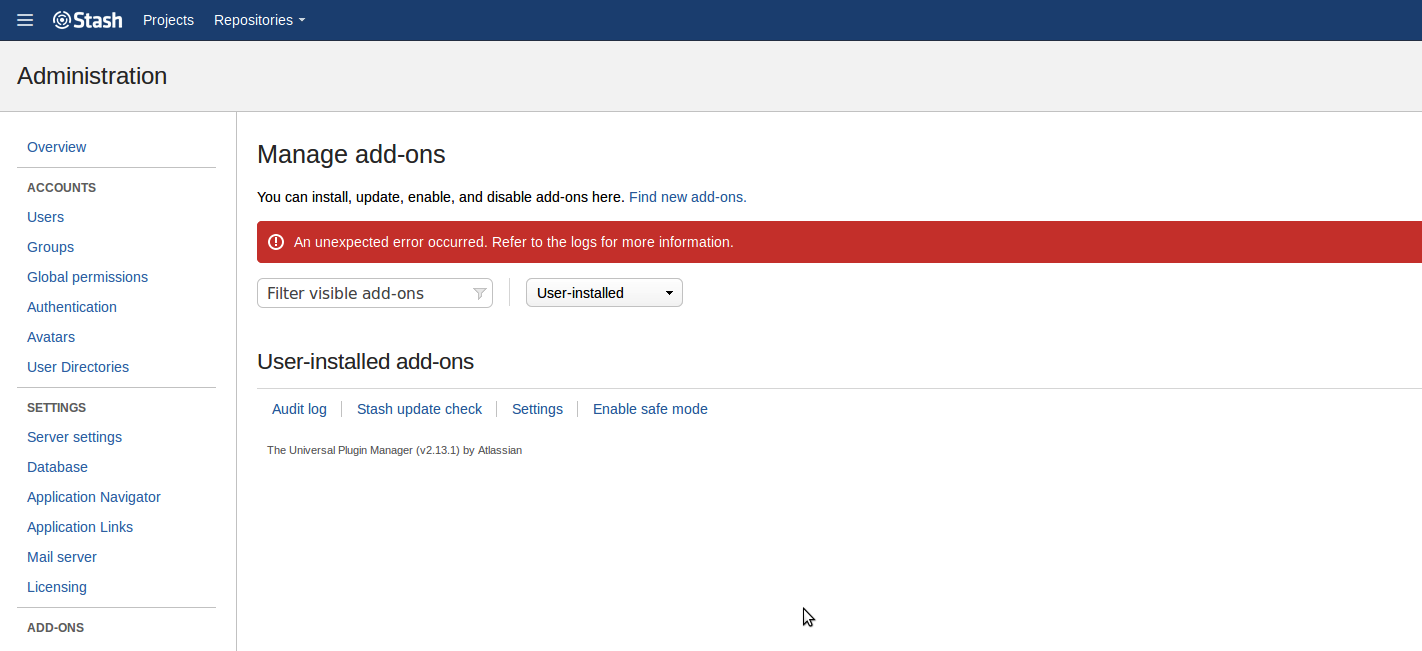

  1. You cannot access the Universal Plugin Manager from "Administration -> Manage add-ons" link.
  2. You may receive an error and see the following screen:
    An unexpected error has occurred. Please refer to the logs for more information.
