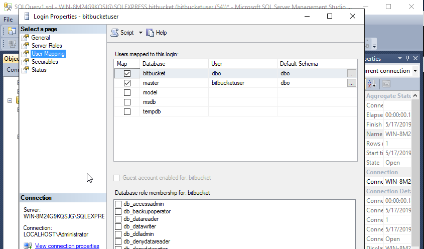

Reported Issue
If you are having issues with permission on objects, when you run the queries in MS SQL, you will need to enable mapping with the master database through the database properties as shown in the image below.
