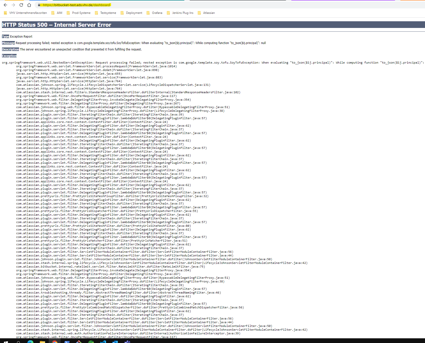

After upgrading Bitbucket on the UI you might see Internal Server error, something like this:

In the atlassian-bitbucket.log, you would see the below stack trace:
1 2 3 4 5 6 7 8 9 10 11 12 13 14 15 16 17 18 19 20 21 22 23 24 25 26 27 28 29 30 31 32 33 34 35 36 37 38 39 40 41 2022-10-11 11:16:08,021 ERROR [http-nio-7990-exec-4] *JRBB5Dx676x89787x0 3q2bbo xx.xx.xx.xxx,xxx.x.x.x "GET /mvc/error500 HTTP/1.1" c.a.s.i.web.ErrorPageController There was an unhandled exception loading [/dashboard] org.springframework.web.util.NestedServletException: Request processing failed; nested exception is com.google.template.soy.tofu.SoyTofuException: When evaluating "to_json($ij.principal)": While computing function "to_json($ij.principal)": null at org.springframework.web.servlet.FrameworkServlet.processRequest(FrameworkServlet.java:1014) at com.atlassian.applinks.core.rest.context.ContextFilter.doFilter(ContextFilter.java:24) at com.atlassian.stash.internal.web.auth.BeforeLoginPluginAuthenticationFilter.doFilter(BeforeLoginPluginAuthenticationFilter.java:73) at com.atlassian.stash.internal.request.DefaultRequestManager.doAsRequest(DefaultRequestManager.java:84) at com.atlassian.stash.internal.hazelcast.ConfigurableWebFilter.doFilter(ConfigurableWebFilter.java:38) at java.base/java.lang.Thread.run(Thread.java:829) ... 291 frames trimmed Caused by: com.google.template.soy.tofu.SoyTofuException: When evaluating "to_json($ij.principal)": While computing function "to_json($ij.principal)": null at bitbucket.internal.app.dashboard.page(dashboard.soy:26) at com.google.template.soy.tofu.internal.BaseTofu.renderMainHelper(BaseTofu.java:369) at com.google.template.soy.tofu.internal.BaseTofu.renderMain(BaseTofu.java:322) at com.atlassian.soy.springmvc.SoyView.render(SoyView.java:50) at com.atlassian.stash.internal.web.soy.StashSoyViewResolver$1.render(StashSoyViewResolver.java:34) ... 36 common frames omitted Caused by: com.google.template.soy.sharedpasses.render.RenderException: When evaluating "to_json($ij.principal)": While computing function "to_json($ij.principal)": null at bitbucket.internal.app.dashboard.page(dashboard.soy:26) at com.google.template.soy.sharedpasses.render.RenderVisitor.eval(RenderVisitor.java:742) at com.google.template.soy.sharedpasses.render.RenderVisitor.visitPrintNode(RenderVisitor.java:248) at com.google.template.soy.soytree.AbstractSoyNodeVisitor.visit(AbstractSoyNodeVisitor.java:87) at com.google.template.soy.soytree.AbstractSoyNodeVisitor.visit(AbstractSoyNodeVisitor.java:56) at com.google.template.soy.basetree.AbstractNodeVisitor.exec(AbstractNodeVisitor.java:40) at com.google.template.soy.tofu.internal.BaseTofu.renderMainHelper(BaseTofu.java:366) ... 46 common frames omitted Caused by: com.google.template.soy.sharedpasses.render.RenderException: While computing function "to_json($ij.principal)": null at com.google.template.soy.sharedpasses.render.EvalVisitor.computeFunctionHelper(EvalVisitor.java:673) at com.google.template.soy.sharedpasses.render.EvalVisitor.visitFunctionNode(EvalVisitor.java:653) at com.google.template.soy.sharedpasses.render.RenderVisitor.eval(RenderVisitor.java:739) ... 66 common frames omitted Caused by: java.lang.NullPointerException: null at com.google.common.base.CharMatcher.replaceFrom(CharMatcher.java:719) at com.atlassian.stash.internal.web.soy.functions.ToJsonFunction.safeJson(ToJsonFunction.java:56) at com.atlassian.soy.impl.modules.CompositeFunctionAdaptor.computeForJava(CompositeFunctionAdaptor.java:38) at com.google.template.soy.sharedpasses.render.EvalVisitor.computeFunctionHelper(EvalVisitor.java:670) ... 75 common frames omitted
