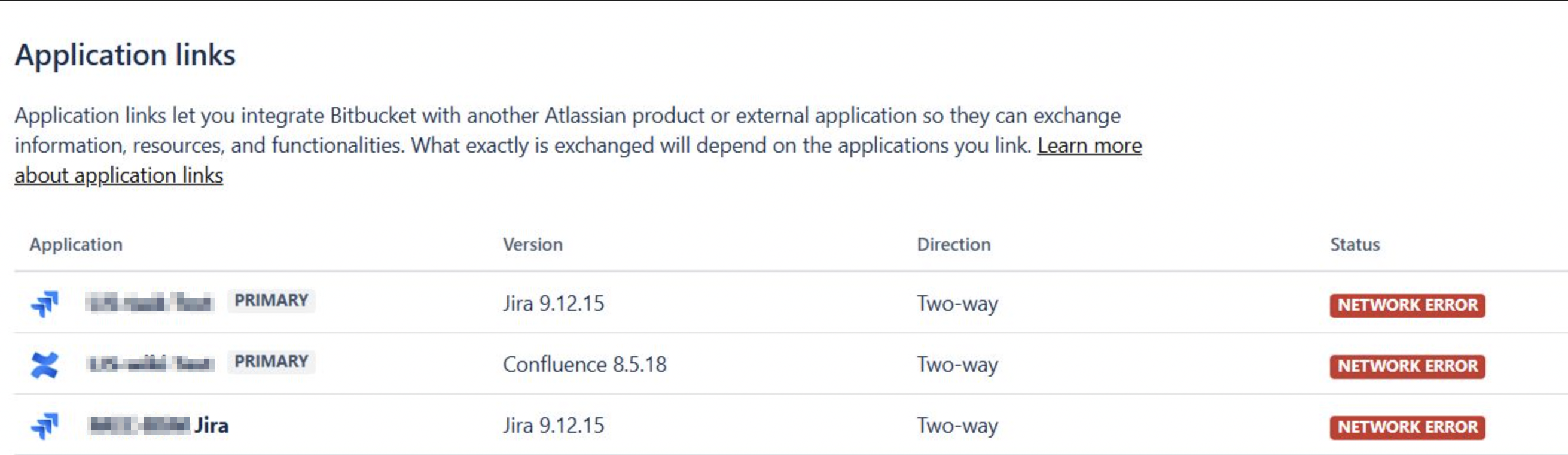

This document helps identify each Application Link that Bitbucket Data Center (formerly Atlassian Stash) has to every other application and then remove the correct one, as desired, directly from the database.

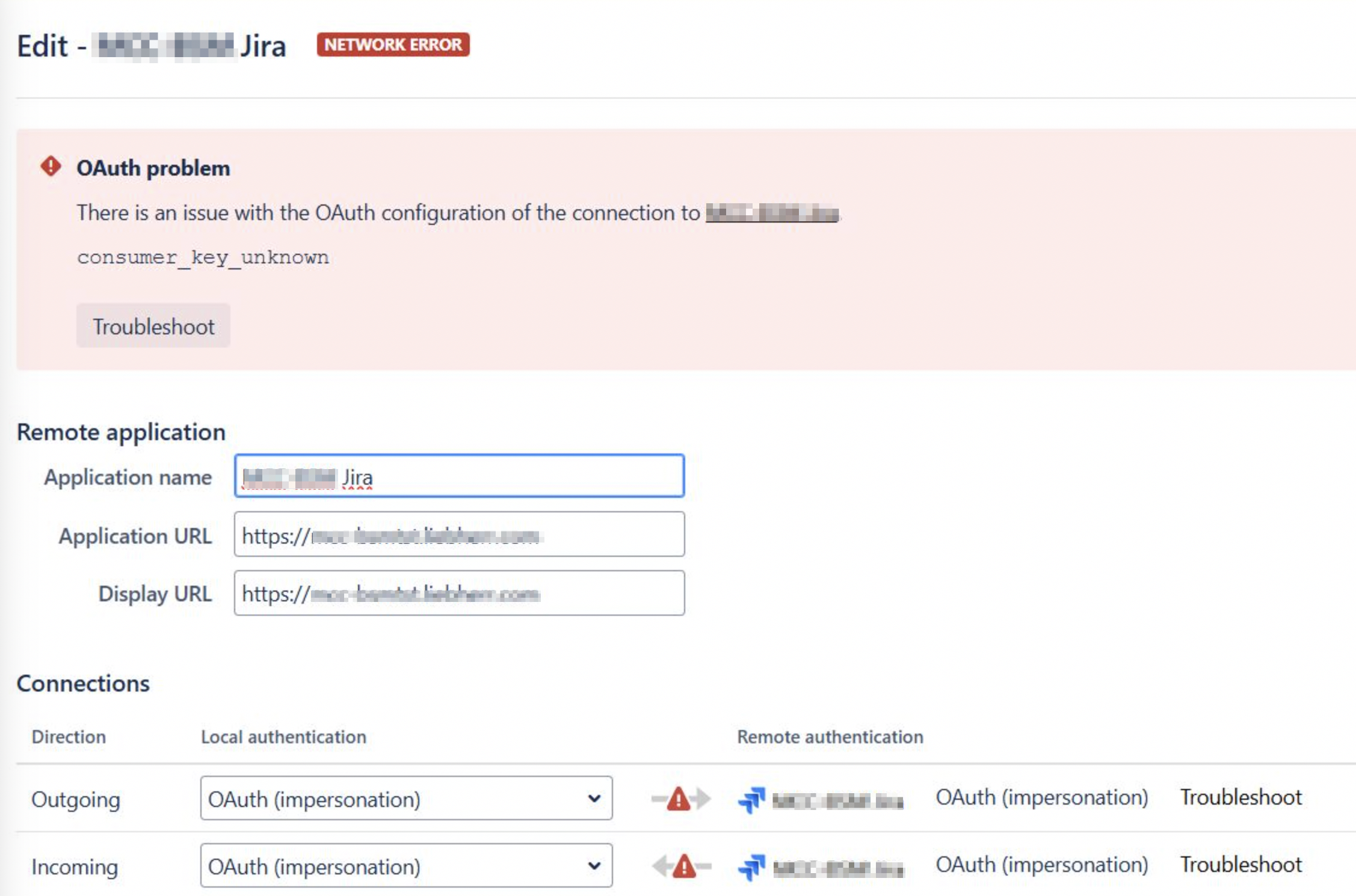

It's useful since some errors may lead to the impossibility of removing an Application Link from the UI, so it can be removed from the database.
One of the possible scenarios -> when Application link showing "Network error" and while editing the application link, we receive "consumer_key_unknown", we can follow these steps:
