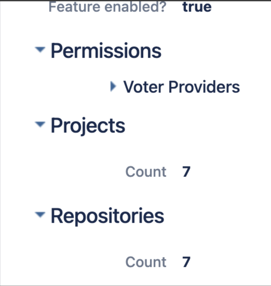

Via UI
Steps:
  • The Administration COG wheel top right-click on it.
  • Troubleshooting and support tools bottom left
  • System Information Tab.
  • Scroll down, and you will see the Project count:
