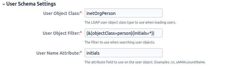

  3. Modify your Bitbucket User Directory Configuration in (⚙) (Administration) > User Management > User Directories so that the "User Name Attribute" and "User Object Filter" (in User Schema Settings) is changed to the temporary attribute.
    • If you used "initials" as the new added attribute, you can add it to the User Scheme Settings in Bitbucket as below:
    • Remember to use the value of "initials" attribute as the User name while retrieving users and groups.
