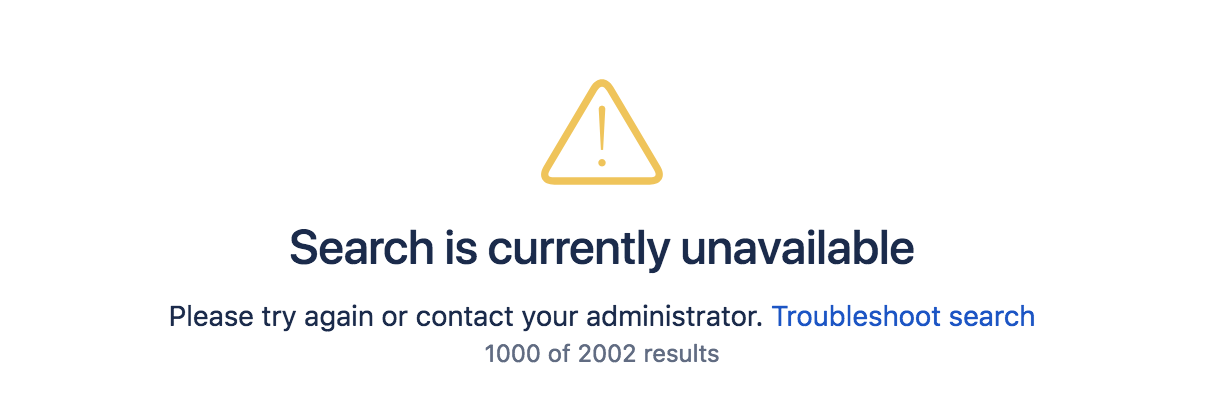

When searching a word which happens to present in more than 1000 files in all of Bitbucket repositories, results can be seen for only the first 1000. Subsequent results are not fetched and we are instead presented with the following alert:

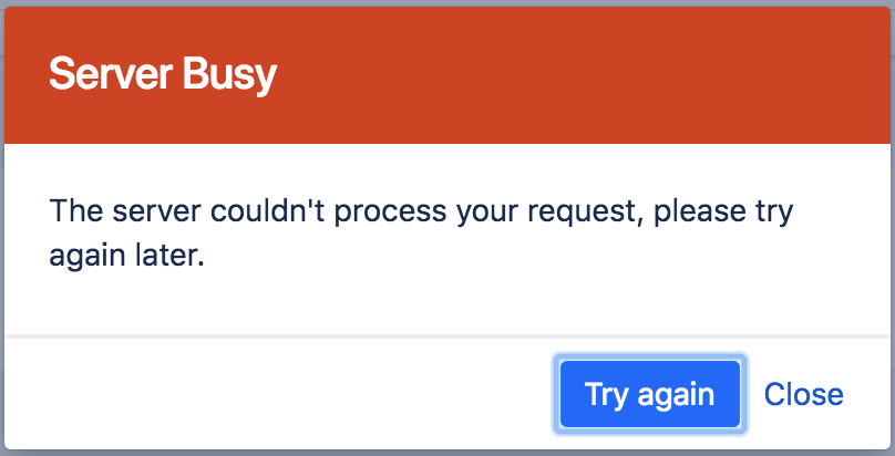

Clicking on the "Try again" button does not help and clicking on close will present a new error at the bottom of the page:
