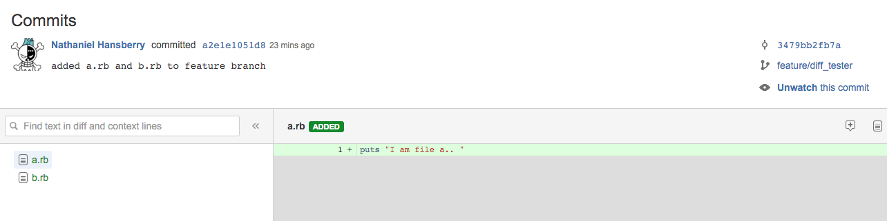

  3. An exact copy of b.rb along with a new file, called a.rb is added, committed and pushed to the feature branch.
  4. A pull request is created to merge the feature (source) branch back into the master (target) branch.
As is shown in the image below, the "Commits" view in the pull request shows both a.rb and b.rb:

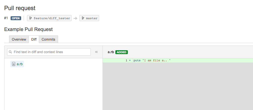

The "Diff" view, however, only shows the a.rb file:
This is because when the feature branch is merged into the master branch, the only difference will be the a.rb file as both master and feature branch contain the exact same b.rb file.
