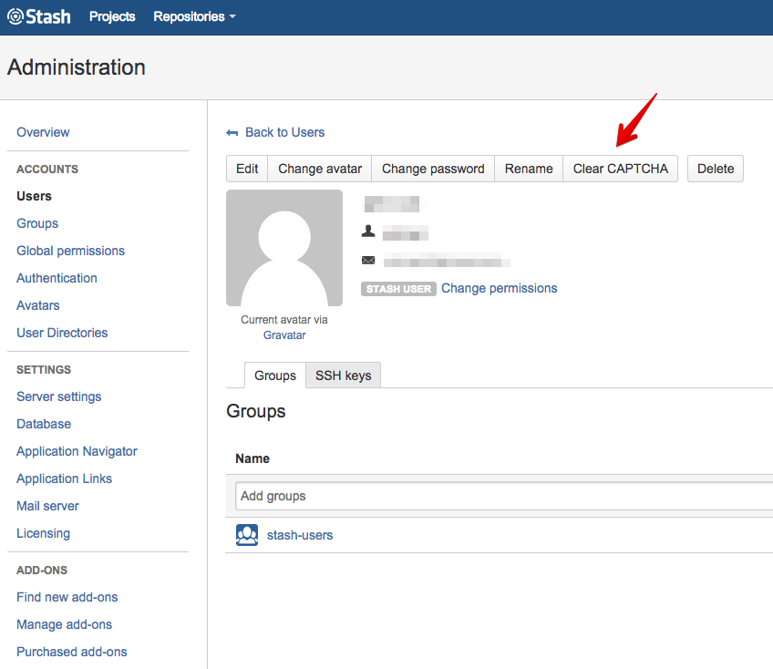

How can I clear CAPTCHA for a specific user?
You can clear captcha for a Bitbucket Data Center user if you have "System Administrator" Global permissions assigned to you directly on the user's page.

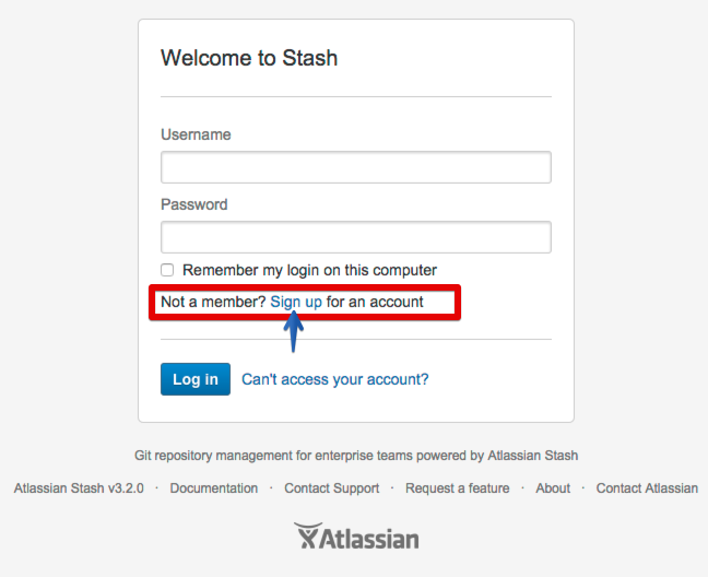

What is the "CAPTCHA on Sign up" I see on the UI?
This CAPTCHA use case is completely different from the CAPTCHA on login as described above. Read on for more details.
The screen below under Administration > Authentication is related to the "Public Sign up" feature (whether to enable it or not) in Bitbucket Data Center. The "Public Sign Up" feature (when enabled) allows external users to create accounts on your Bitbucket Data Center instance through the login screen. Thus you might be able to make sure only humans are signing up to your public instance by enabling CAPTCHA. Notice that the CAPTCHA option can only be enabled if you "Allow public sign up".
When you enable that feature, the following is added to your Bitbucket Data Center login screen:
The CAPTCHA option on the first image refers to enabling CAPTCHA during the "Public Sign up" process and has nothing to do with the login CAPTCHA. See, for example, a signup screen for an instance that's got it enabled:
