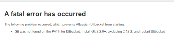

When starting up Bitbucket Server, unable to locate git on the PATH for Bitbucket Server
1 2 3 ERROR [main] c.a.s.i.scm.PluginScmClientProvider *************************************************************************** ERROR [main] c.a.s.i.scm.PluginScmClientProvider git was not found on the PATH for Bitbucket Server. Please add git version 1.7.6 or Restart Bitbucket Server. ERROR [main] c.a.s.i.scm.PluginScmClientProvider **************************************************************************
The following screen may also be seen in UI:
