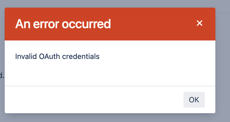

The problem is reproduced by doing the following steps:
  1. Generate OAuth Credentials from Jira Cloud
    • Add one or more permissions except for Development information
  2. Go to Bitbucket Data Center's Jira Cloud Integration page (Administration > System > Jira Cloud Integration)
  3. Click on Register site
  4. Add the credentials generated from step 1 and save.  An error is displayed.
  5. The debug logs show the following:
DEBUG [http-nio-22110-exec-6] bitbucket @19X73F5x939x153x0 e615o1 0:0:0:0:0:0:0:1 "POST /rest/jira-dev/latest/jira-site-config HTTP/1.1" c.a.s.i.r.e.ServiceExceptionMapper Mapping ServiceException to REST response 400 com.atlassian.stash.internal.jira.cloud.config.exception.InvalidOauthCredentialException: Invalid OAuth credentials at com.atlassian.stash.internal.jira.cloud.config.service.DefaultJiraSiteConfigService.validateOauthCredentials(DefaultJiraSiteConfigService.java:232) at com.atlassian.stash.internal.jira.cloud.config.service.DefaultJiraSiteConfigService.create(DefaultJiraSiteConfigService.java:85) at com.atlassian.stash.internal.jira.rest.JiraSiteConfigurationResource.create(JiraSiteConfigurationResource.java:46) .. .. Caused by: com.atlassian.stash.internal.jira.http.client.exception.HttpClientException: Forbidden at com.atlassian.stash.internal.jira.http.json.DefaultHttpRequestExecutor.lambda$null$3(DefaultHttpRequestExecutor.java:74) at com.atlassian.httpclient.api.ResponsePromiseMapFunction.apply(ResponsePromiseMapFunction.java:49) at com.atlassian.httpclient.api.ResponsePromiseMapFunction.apply(ResponsePromiseMapFunction.java:10) at io.atlassian.util.concurrent.Promises$OfStage.lambda$fold$4(Promises.java:332) at io.atlassian.util.concurrent.Promises.lambda$biFunction$7(Promises.java:422)
