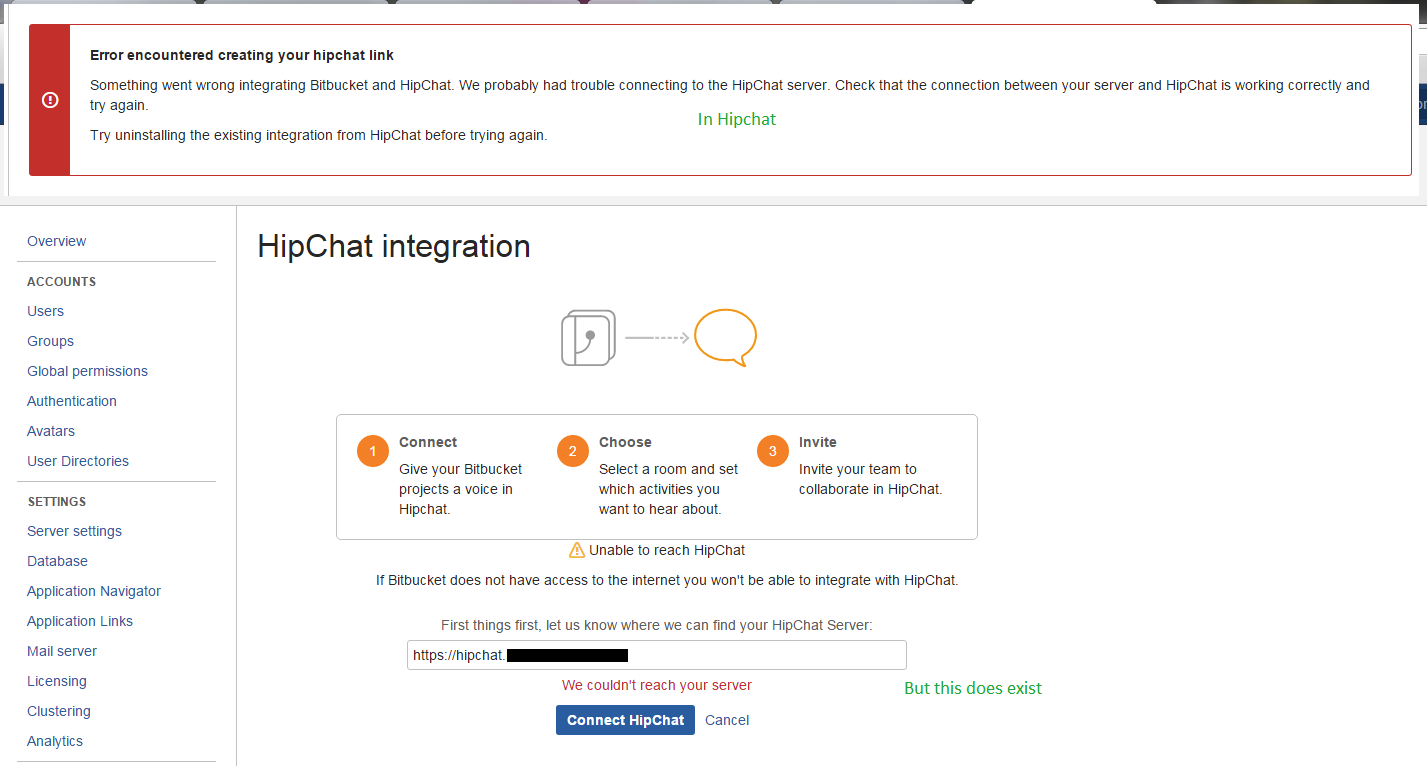

The error illustrated below occurs when trying to re-configure Bitbucket Server to HipChat Server integration.
Error encountered creating your hipchat link Something went wrong integrating Bitbucket and HipChat. We probably had trouble connecting to the HipChat server. Check that the connection between your server and HipChat is working correctly and try again.
After clicking "Connect HipChat" from Bitbucket Server and you get re-directed to HipChat. Clicking the Install button from HipChat redirects you to the error shown above.
