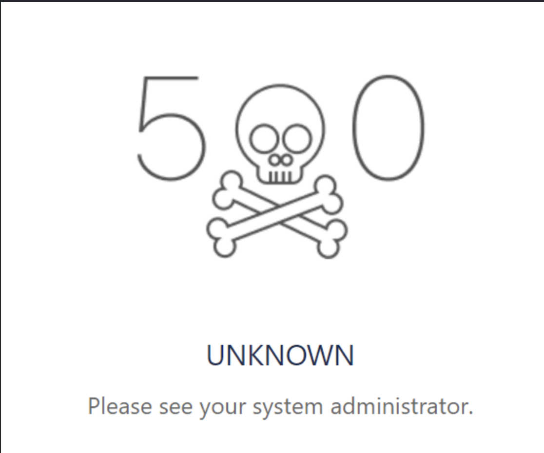

The following error visible in the Bitbucket UI:
The following appears in atlassian-bitbucket.log:
1 2 3 4 5 6 7 8 9 10 11 12 2024-07-02 07:34:29,214 WARN [http-nio-7990-exec-2] e123456 *NX9HIHx454x1938264x1 e789456 10.xx.xx.xx,10.xx.xx.xx "GET /plugins/servlet/troubleshooting/view/system-info/view HTTP/1.1" c.z.n.internal.BasePosixProcess Failed to start process java.io.IOException: error=2, No such file or directory at com.zaxxer.nuprocess.internal.LibJava10.Java_java_lang_ProcessImpl_forkAndExec(Native Method) at com.zaxxer.nuprocess.linux.LinuxProcess.prepareProcess(LinuxProcess.java:158) at com.zaxxer.nuprocess.linux.LinuxProcess.run(LinuxProcess.java:98) 2024-07-02 07:34:29,214 DEBUG [http-nio-7990-exec-2] e123456 *NX9HIHx454x1938264x1 e789456 10.xx.xx.xx,10.xx.xx.xx "GET /plugins/servlet/troubleshooting/view/system-info/view HTTP/1.1" c.a.bitbucket.dmz.process.NioProcess 0: [/xyz/abc/gitclient-2.35.7/git-2.35.7/git version] exited -2147483648 in 1719920069214ms (stdin: 0, stdout: 0, stderr: 0) 2024-07-02 07:34:29,215 WARN [http-nio-7990-exec-2] e123456 *NX9HIHx454x1938264x1 e789456 10.xx.xx.xx,10.xx.xx.xx "GET /plugins/servlet/troubleshooting/view/system-info/view HTTP/1.1" c.a.s.i.scm.git.stp.GitSupportInfo Failed to retrieve Git version com.atlassian.bitbucket.scm.CommandFailedException: '/xyz/abc/gitclient-2.35.7/git-2.35.7/git version' could not be started at com.atlassian.bitbucket.internal.process.nu.NioNuProcessHandler.ensureStarted(NioNuProcessHandler.java:351) at com.atlassian.bitbucket.internal.process.nu.NioNuProcessHandler.finish(NioNuProcessHandler.java:374) at com.atlassian.bitbucket.internal.process.nu.NioNuProcessHandler.onExit(NioNuProcessHandler.java:138)
