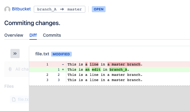

Steps: branch_Amaster
Bitbucket 7
Bitbucket 6

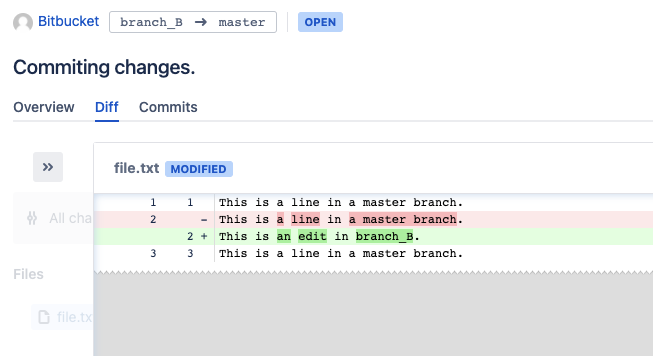

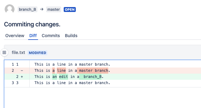

Steps: branch_Bmaster
Bitbucket 7
Bitbucket 6

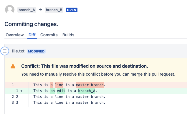

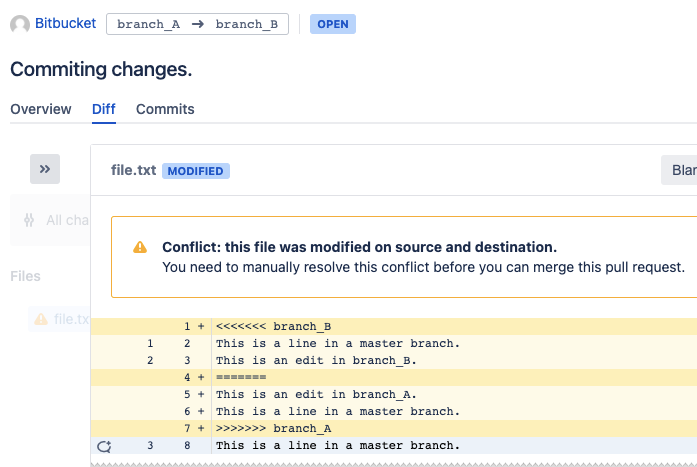

Steps: branch_Abranch_b
Bitbucket 7
Bitbucket 6
As you can see in the last comparison - in Bitbucket 6 the Pull Request Diff presents a direct comparison between branch_A and branch_B.
In Bitbucket 7 however, the comparison is presented between branch_A (the source branch) and the common ancestor of both branch_A and branch_B, which in that particular case is the last commit in the master branch. In other words - the last commit shared between the source and the target.
Please be advised that in both cases, a conflict was detected, as the same file was modified on source and destination.
