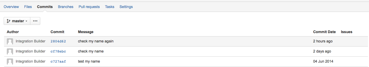

Frequently, new Bitbucket Data Center users believe that the user that pushes changes to Bitbucket should be listed in the Author column of the commits displayed in the UI. Take, for example, the following screenshot:
While the Author column displays "Integration Builder," the user who performed the commit, the user who pushed the code to the repository was a different user, "Test1".

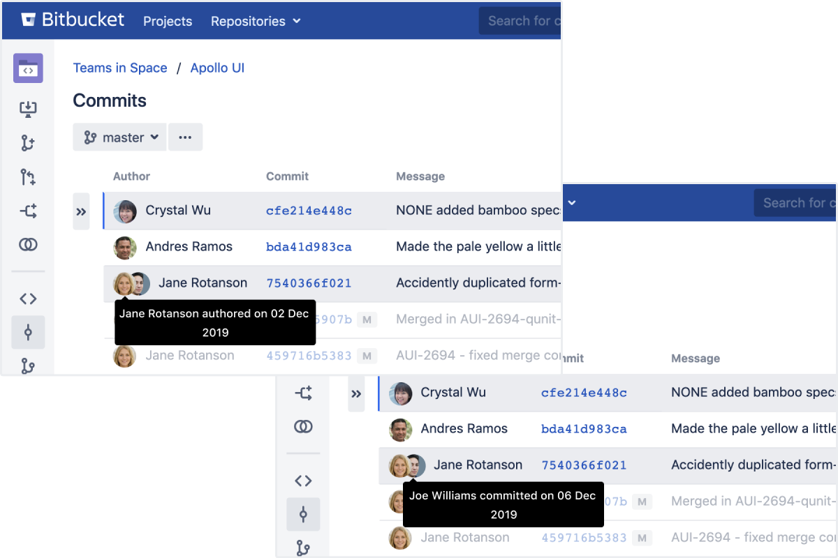

The Bitbucket user who pushed the changes is not displayed anywhere in the UI in Bitbucket older than 6.9. In Bitbucket 6.9 and newer, you can see the Avatars of both the committer and user who pushed under the Author column, as shown below.
