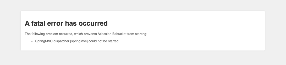

Bitbucket Mesh Sidecar may fail to start up or experience a delay in starting up which can cause the connection from Bitbucket to timeout. Because Sidecar handles the local SCM tasks for Bitbucket, this failure can result in startup failures with the Web UI displaying an error such as:
SpringMVC dispatch springMVC could not be started
