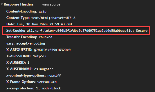

On first being directed to Bitbucket, if you open Chrome Developer Tools (F12) → Network → authorize?oauth_callback... and review the Response Headers section, the following cookie should be getting set:
However - instead, the following cookies are the only ones present when the request is submitted to Bitbucket on hitting the 'approve' button:
1 2 3 4 5 6 7 8 9 10 11 12 13 14 15 16 17 18 19 20 21 22 23 "cookies": [ { "name": "BITBUCKETSESSIONID", "value": "REALLYLONGHEXADECIMALSTRING", "expires": null, "httpOnly": false, "secure": false }, { "name": "_atl_bitbucket_remember_me", "value": "ANOTHERREALLYLONGRANDOMSTRING", "expires": null, "httpOnly": false, "secure": false }, { "name": "wit-announce-token", "value": "REALLYLONGHEXADECIMALSTRING-BUT-THIS-TIME-WITH-DASHES", "expires": null, "httpOnly": false, "secure": false } ],
Cause
The expected atl.xsrf.token cookie is not being set due to an installed third-party plugin that is removing the cookie or blocking it from being set in the first place.
