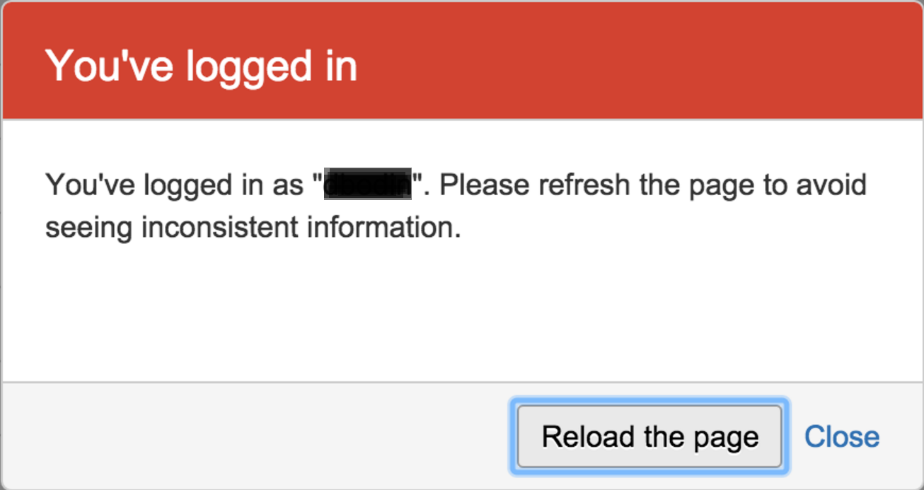

B. The following message is displayed in the application:
For example:
1 You've logged in as "drohan". Please refresh the page to avoid seeing inconsistent information.
