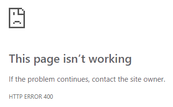

On versions prior to 6.0, the above error will not display - and you will receive an HTTP 400 error without any other information, such as the following:
To confirm that you are being impacted by this issue while on a version lower than 6.0, we recommend enabling Apache Tomcat access logging and reviewing the error in the Apache access log.
