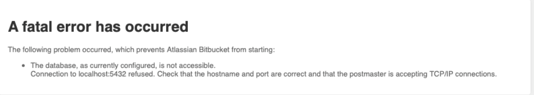

Scenario #1:
When starting Bitbucket Service, the following is shown on the browser:
