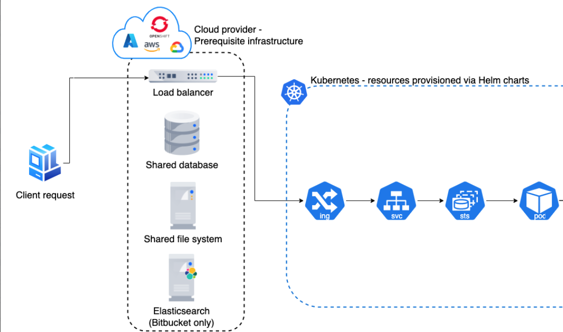

Here's a flow diagram of the user request from an External Load Balancer up until the Kubernetes pod:
Diagram of the user request from an External Load Balancer up until the Kubernetes pod.
In the above diagram, we can see that Client is sending a request to External Load Balancer and External Load Balancer further sending a request to Ingress Controller. Ingress controller internally communicates with Kubernetes service and Kubernetes pod.
