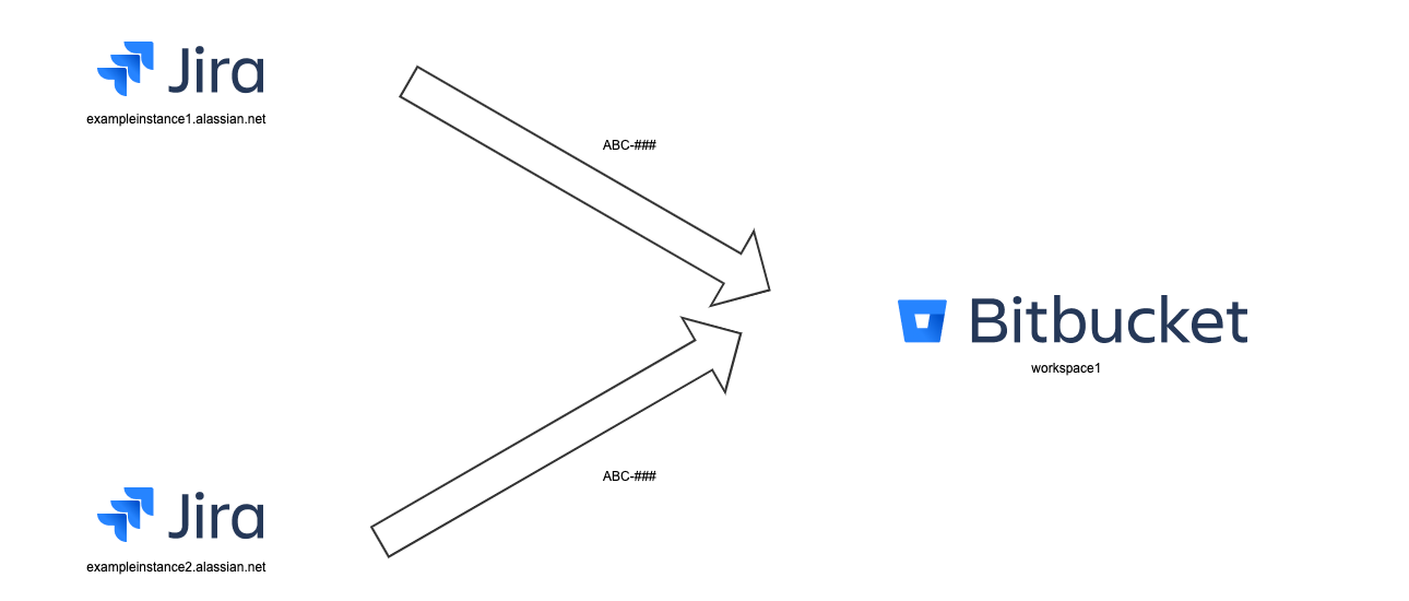

If both Jira instances have issue keys like ABC-### and ABC-###. For example, let's say we have "exampleinstance1.atlassian.net" and "exampleinstance2.atlassian.net" linked to a Bitbucket Cloud workspace called "workspace1". See the diagram below to better understand the example scenario:
If both instances have a project that is using ABC-### as its key, and a Bitbucket Cloud pull request comment mentions an issue with the key ABC-1, then the Jira link will always redirect the user to the instance that was linked to Bitbucket Cloud first. So in the example scenario above, if "exampleinstance1.atlassian.net" was the first Jira instance that was linked to "worspace1", and if "exampleinstance2.atlassian.net" also has an issue key that matches the issue that was mentioned, then the user will always get redirected to "exampleinstance1.atlassian.net" to resolve the conflict. The user will also get redirected to "exampleinstance1.atlassian.net" even if this Jira instance no longer exists.
