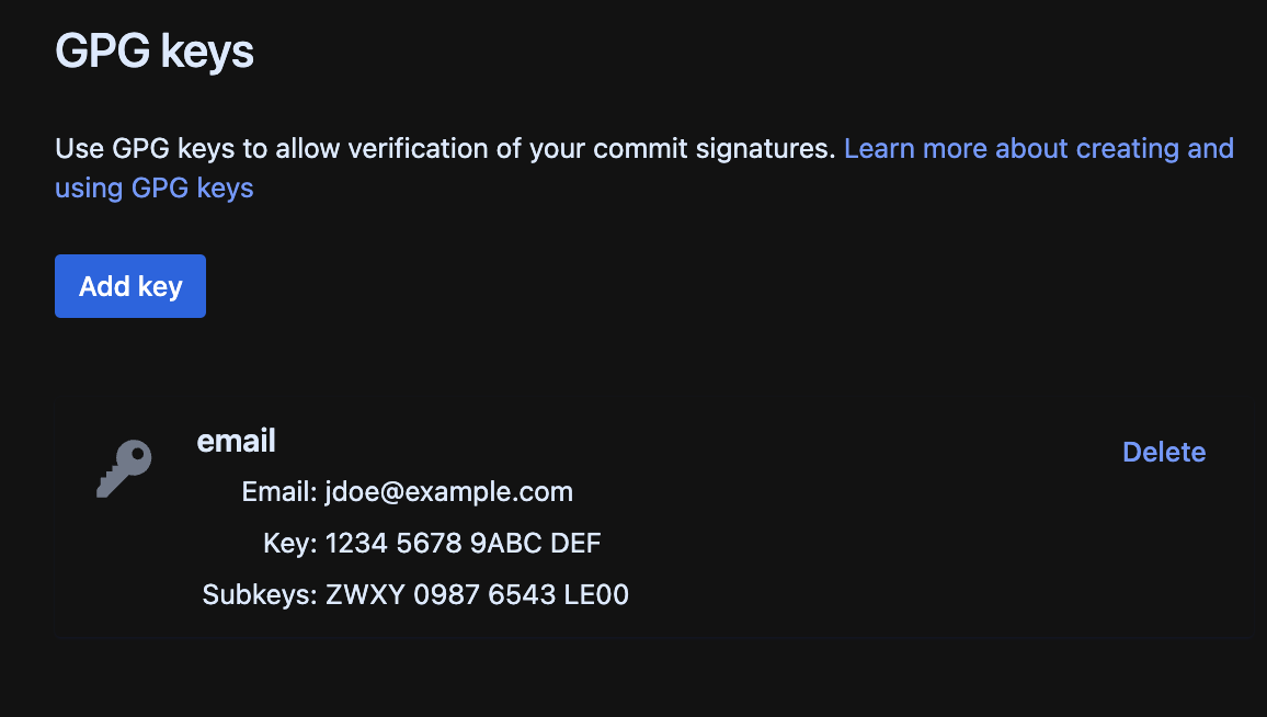

    3. In Bitbucket, navigate to your personal settings > GPG keys. Make sure the output above matches with the key in Bitbucket (GPG Signing Key, Email and Sub key)
