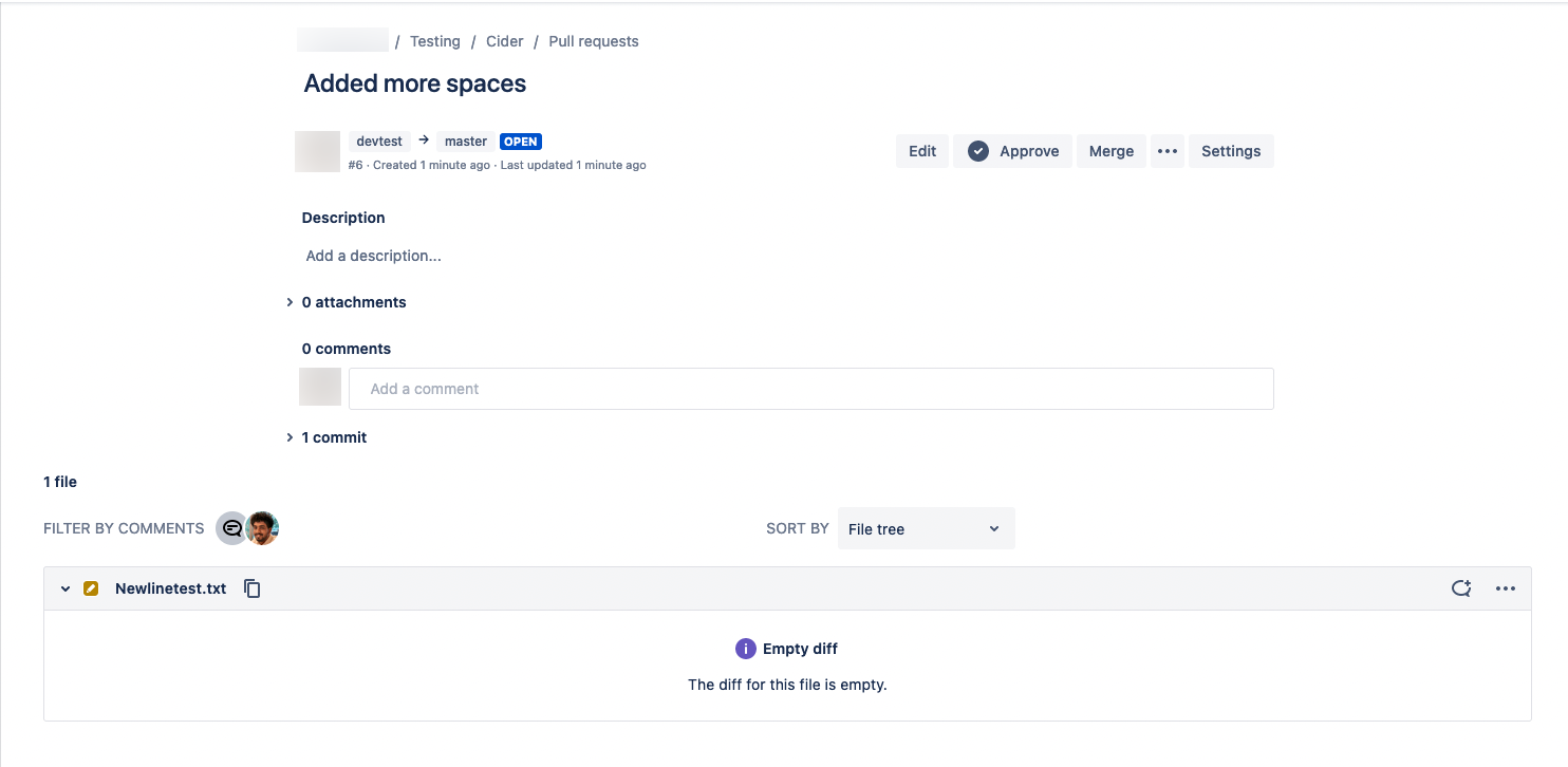

This issue generally occurs when the changes made between branches of a Pull Request only contain spaces. There is a setting within each Pull Request to not show "Whitespace changes". When the Pull Request diff is evaluated, if the diff only contains whitespaces, the diff is not shown if the "Whitespace changes" option is left unchecked.

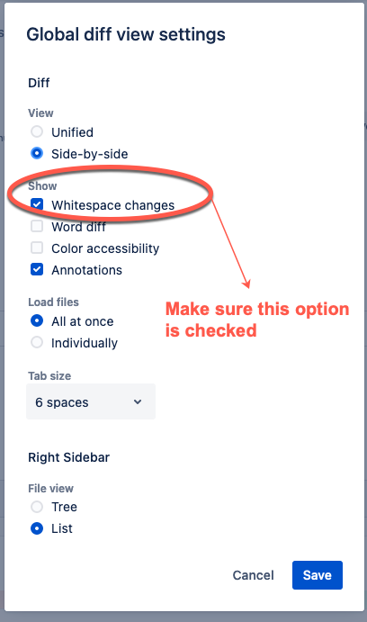

To resolve this issue,
  1. Go to Settings within a Pull Request
  2. Make sure the Whitespace Changes option is checked

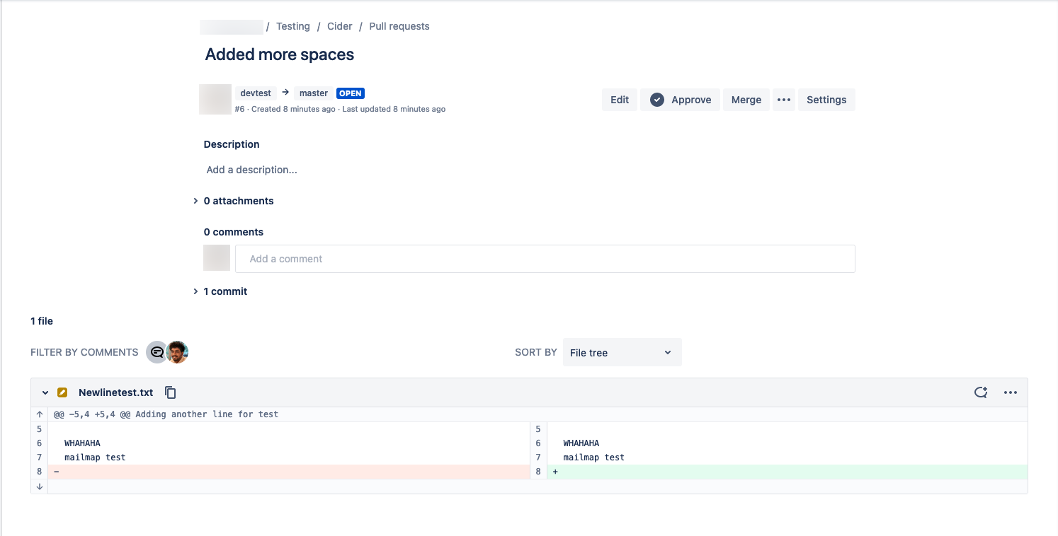

Below are two screenshots for comparison -
Whitespace Changes is left unchecked
ℹ️ Whitespace Setting is unchecked
ℹ️ Whitespace Setting is checked

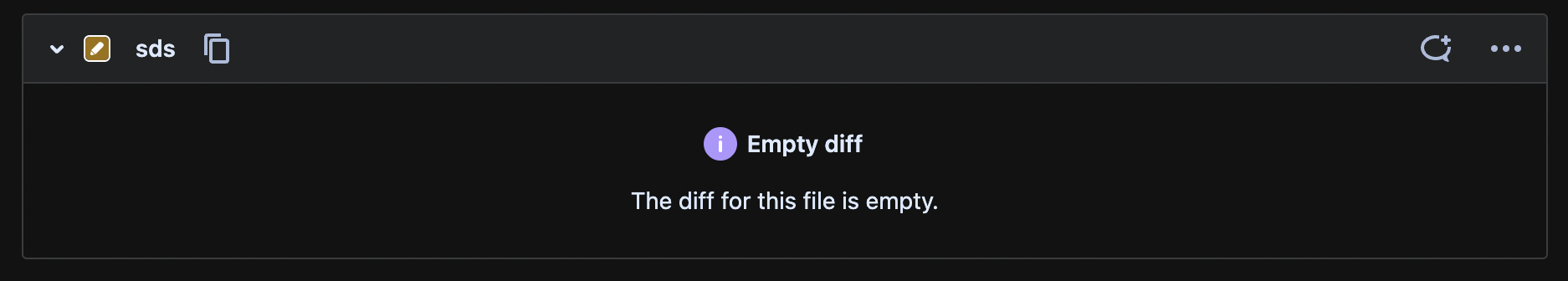

When viewing a commit or a pull request in Bitbucket Cloud, you will see a message stating that the diff is empty or that the contents are unchanged, like the examples below:
Example from the Pull request page:
Example from the Commits page:
Cause 2
The contents of the file in question have truly not changed. However, Git keeps track of file-system permission changes, and this is the reason why you see the file on the diff in Bitbucket Cloud.
