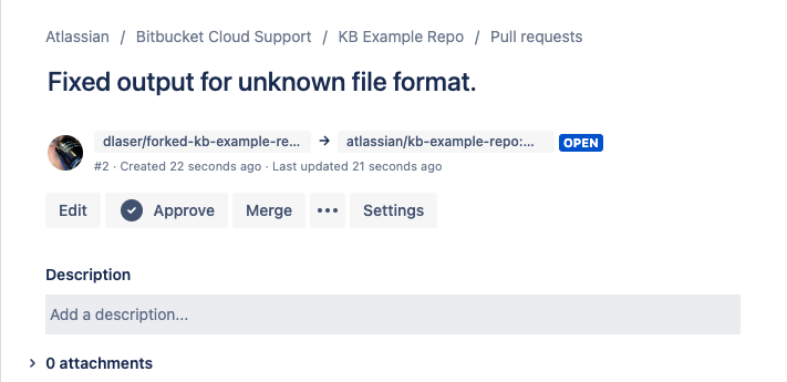

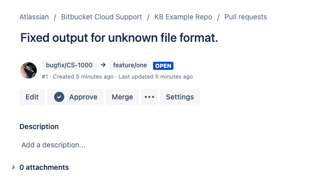

  1. Get the URL of the Merge request. In this example it is https://bitbucket.org/atlassian/kb-example-repo/pull-requests/1. The second screenshot is an example of a pull request from a forked repository with the url: https://bitbucket.org/atlassian/kb-example-repo/pull-requests/2.
    • (Auto-migrated image: description temporarily unavailable)
      The source and destination branch names can be copied from the UI as shown in the above screenshot. Alternatively, you can also use the below API query to get the branch names in a pull request.
