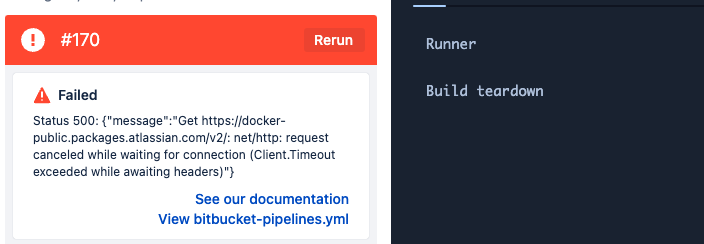

One may encounter the following error either while setting up Kubernetes runners, or while executing the build setup step:

Several factors may contribute to the occurrence of the "canceled while waiting for connection" error, including:
  • Slow network connection, Firewall, or proxy issues: The timeout may have occurred due to a slow or unstable network connection, or, it could be a firewall/proxy that is blocking the request and resulting in a timeout error.
