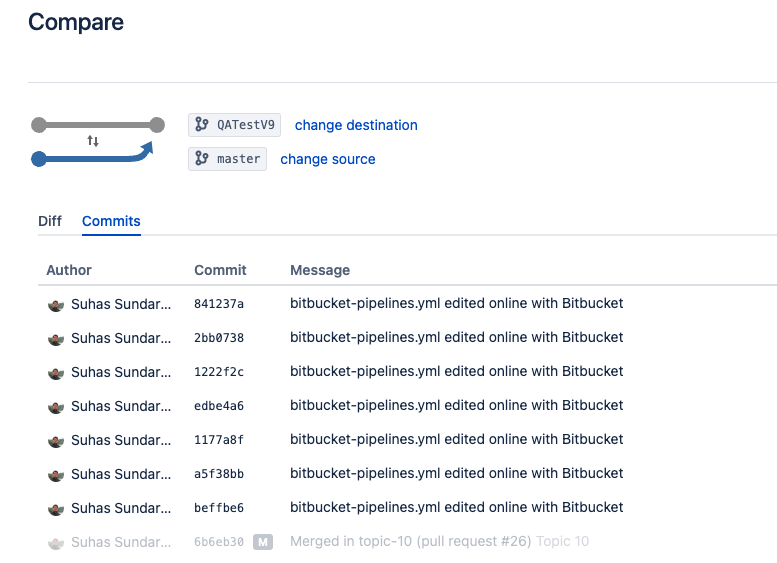

When comparing branches, we can view the commits listed that are part of the source branch, not the destination branch.
Branch Compare Page View:

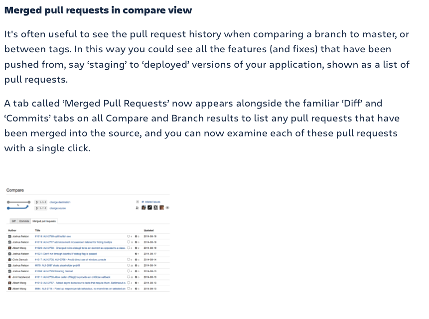

Previously, the Bitbucket branch compare page had a "merged pull requests" tab, displaying a list of pull requests merged into the source branch.
However, this tab has been deprecated, as noted in this Atlassian Community post. There are a couple of workarounds that could be used in place of the missing "merged pull requests" tab:
