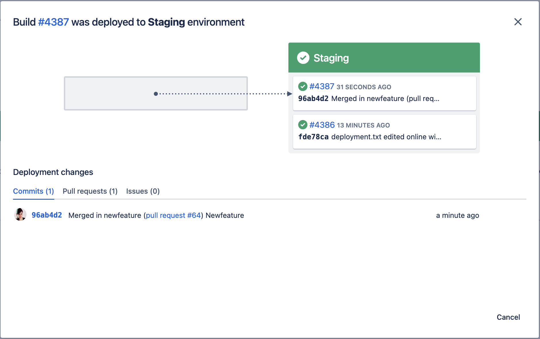

  1. Let's say the latest commit deployed to the staging environment is commit S(702824a) which is on the main branch
  2. Create a feature branch from the main branch and add a few commits - A(fde78ca) and B(54bb14e)
  3. Deploy these commits from the feature branch to the staging environment, deployment D1(#4386)
  4. Create a pull request from feature to the main branch
  5. Merge the pull request with a merge commit strategy, 96ab4d2 is the merge commit in this example.
  6. Deploy the merge commit to the staging environment - deployment D2(#4387), we could see that only the new merge commit is included in the commits list.

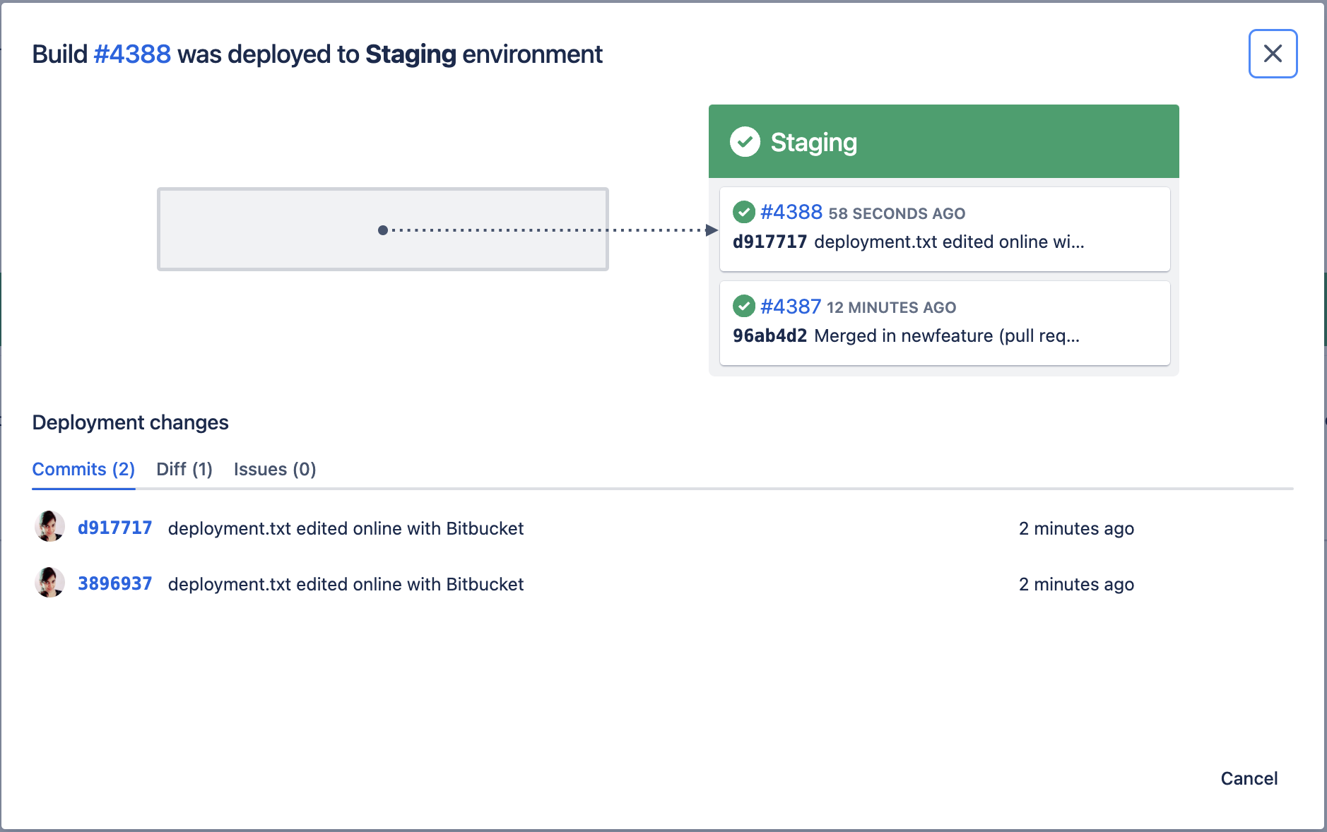

The steps to reproduce are the same as before described in our ideal scenario except for deleting the feature branch on merge with "Close source branch" on merge option with squash merge strategy. Continuing with the same example as above,
  1. Let's say the latest commit deployed to staging environment is commit S(96ab4d2) which is on the main branch
  2. Create a feature branch from the main branch and add a few commits - A(d917717) and B(3896937)
  3. Deploy these commits from feature branch to the staging environment, deployment D1(#4388)

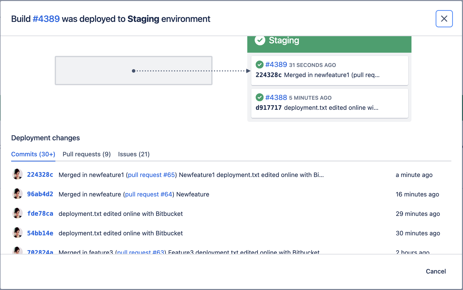

  5. Merge the pull request with a squash merge strategy, 224328c is the merge commit in this example.
  6. Deploy the commit from merge to the staging environment - deployment D2(#4388), we could see that all the previously deployed commits are in the list.

The behavior occurs from performing a squash merge and deleting the source branch. If the source branch is not deleted, it means the commit is still in the repository and is reachable. Then you won't see the past commits in the deployments as they will be in a reachable state. To avoid this behaviour, you could avoid deleting the source branch, as the commit would then meet the aforementioned criteria.
