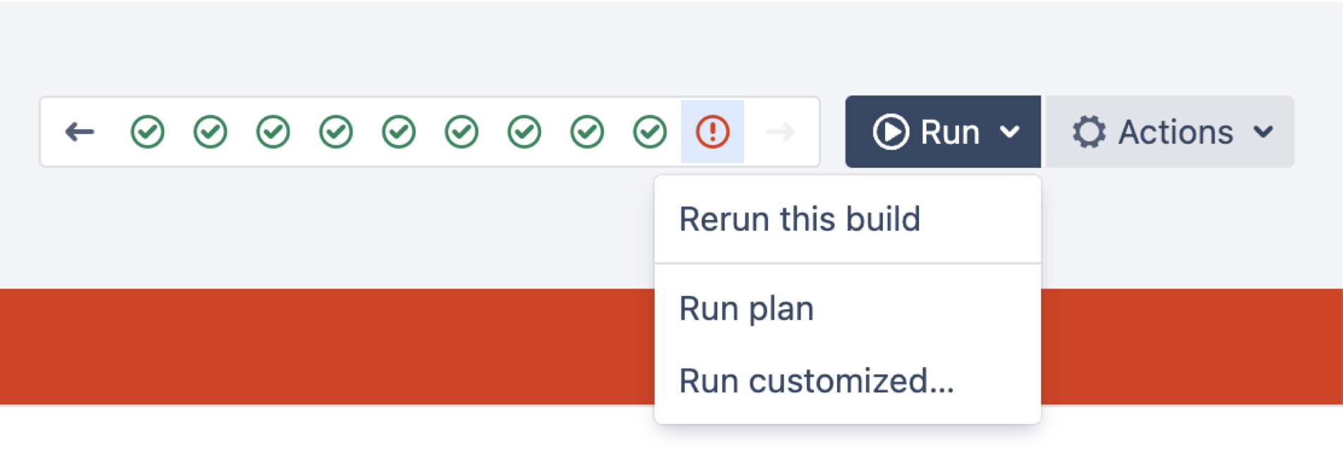

For a particular failed build in Bamboo the option of "Rerun failed/incomplete jobs only" was not available, Please see the image below.
Expected:
Actual :
Actual

  1. Navigate to the failed build via Build >> All build plans >> click on the build Id.
  2. Choose the failed build number and click on Run.
  3. Attached image under Summary section shows the missing option of "Rerun failed/incomplete jobs only"

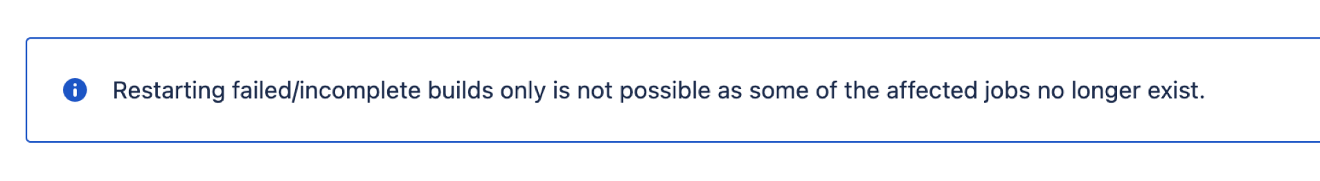

Cause 1 : Modifying the current Plan on which the build has failed.
  • Under a Plan stage If you delete the affected Job for which the build failed and add a new Job, the option will not be visible in the dropdown and the below info will be visible on the screen.
