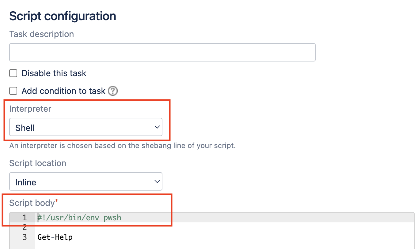

We can force the Script Task to use PowerShell through the steps below:
  1. On your Script Task, make sure the Interpreter is set as Shell.
  2. Replace the shebang from your inline/file script with the following:
    #!/usr/bin/env pwsh
That's it!
